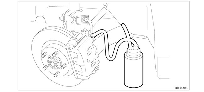

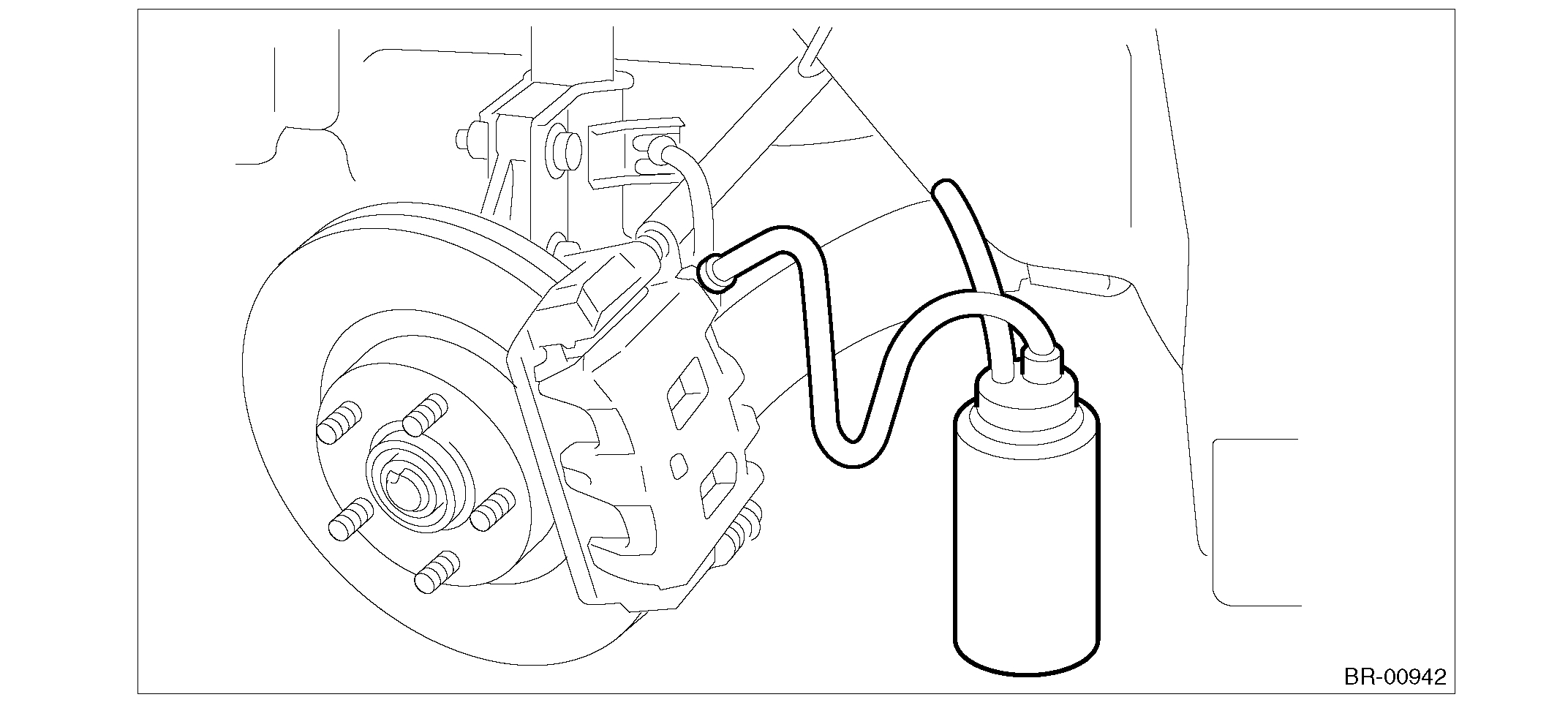

3. Attach one end of the vinyl tube to the bleeder - screw and the other end to the brake fluid container.
pic 1
4. Depress the brake pedal several times, and hold it.
5. Loosen the bleeder - screw to drain brake fluid. Tighten the bleeder - screw quickly, and release the brake pedal.
6. Repeat the steps 4) to 5) until there are no more air bubbles in the vinyl tube.

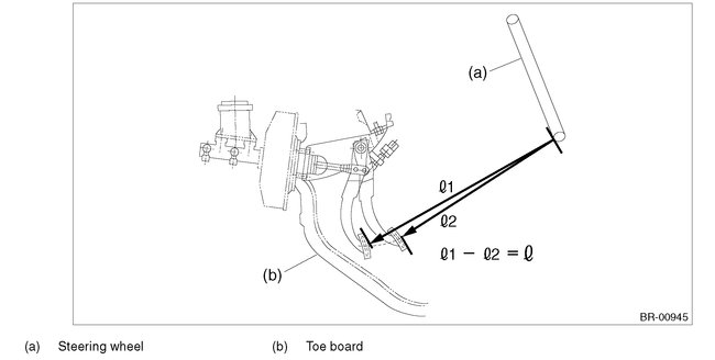

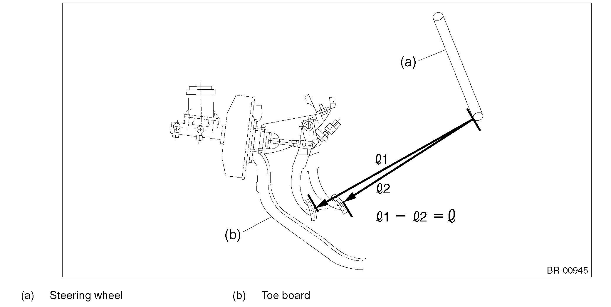

10. Check the pedal stroke.
(1)Warm up the engine until the engine speed stabilizes.
(2)Depress and hold the brake pedal with a force of 500 N (51 kgf, 112 lbf).
(3)Adjust the tilt position of the steering wheel to the lowest position.
(4)Measure the distance between brake pedal and steering wheel.
(5)Release the pedal, and measure the distance between pedal and steering wheel again.
pic 2
Specification of pedal stroke: 110 mm (4.33 in) or less when depressing the pedal with a force of 500 N (51 kgf, 112 lbf)
11. If the distance is more than specification, there is a possibility of air being caught in the brake line. Bleed the brake line of all air until the pedal stroke meets the specification.

Okay, when you push the brake, fluid will go to the caliper. When you release the brake pedal if the bleeder is still open, it will suck air back in. You have to close the bleeder before you release the brake pedal or you will never get the air out of the system. You keep sucking more in. That's why you have no brake pedal.
Try what I suggested and let me know the results. If you need me to better explain, let me know.

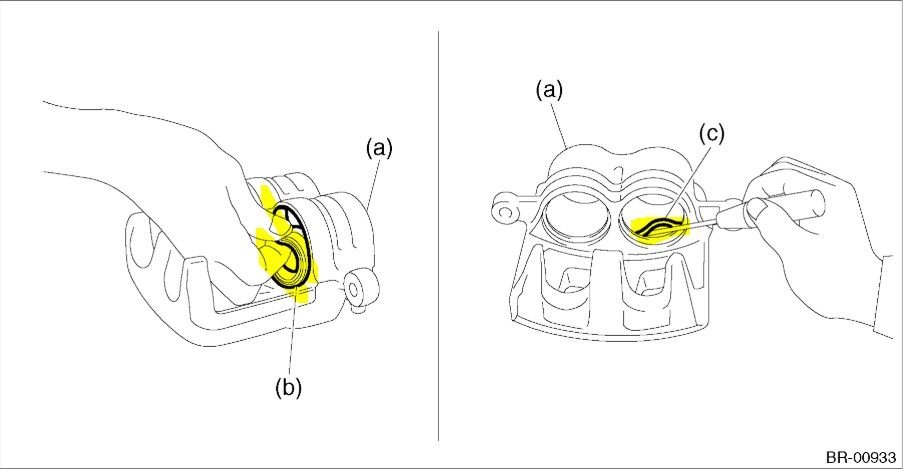

You are very welcome. I'm glad you got it taken care of. I have to be honest, if you had a leak coming from the dust seal, chances are the piston seal got damaged when installing. They need to be lubricated with brake fluid before you reinstall the pistons. I'm not sure if you did that. As far as the dust cover, it isn't responsible for doing anything but keeping dust and dirt from getting between the caliper and pistons. I attached a pic. The left one is the dust seal which you would have installed after the pistons were reinstalled, and the right picture is the actual seal in the bore. That is the one that had to cause the leak.
