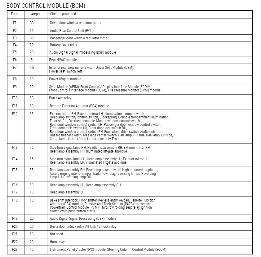

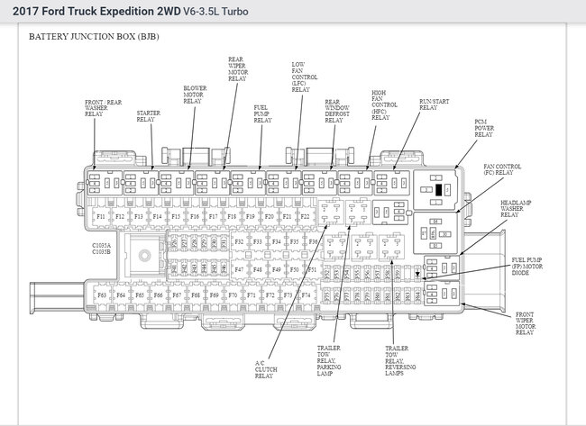

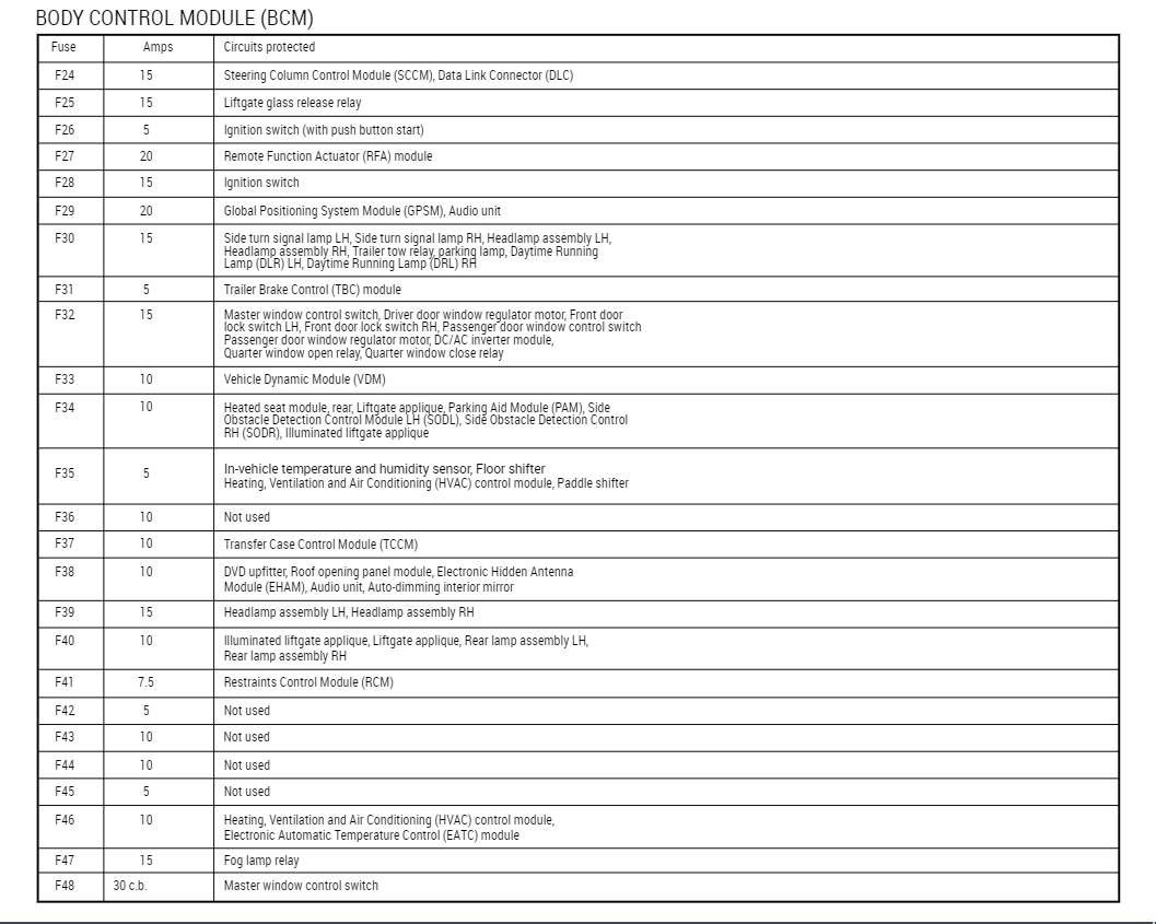

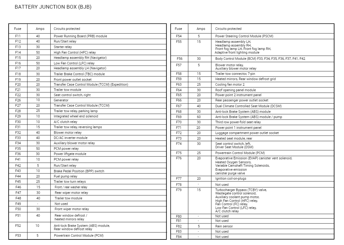

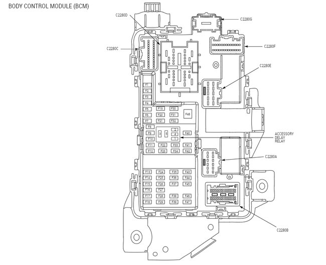

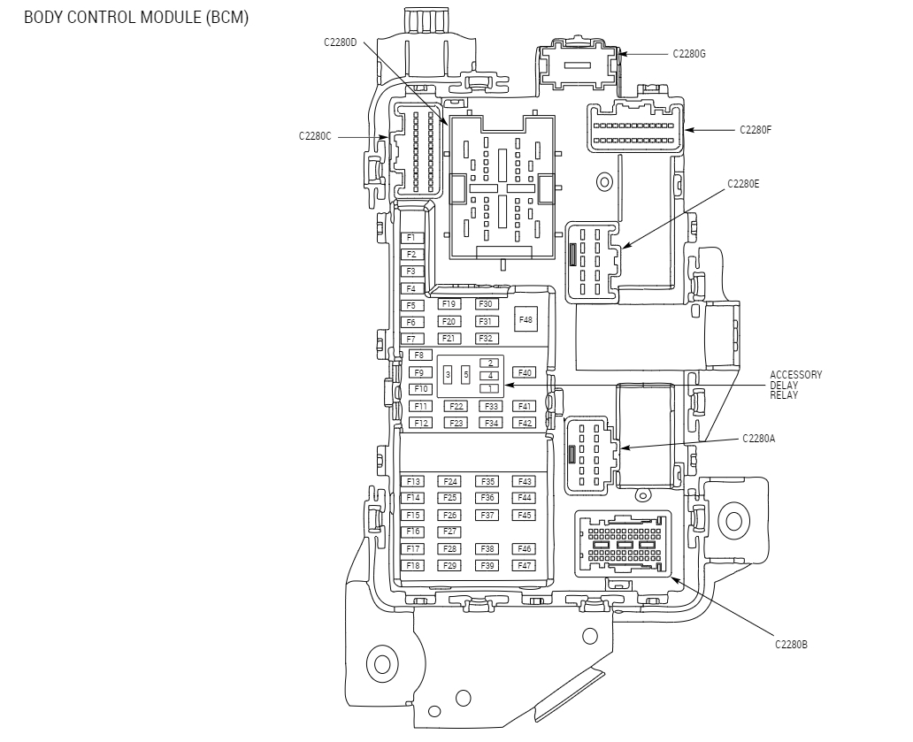

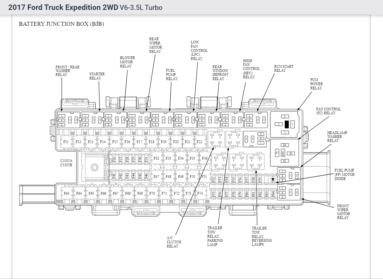

There are two fuses that run the system we need to check for power, fuse # 32 in the under-hood fuse panel and fuse # 46 in the fuse box in the right kick panel. Here is a guide to help you check the fuses for power:

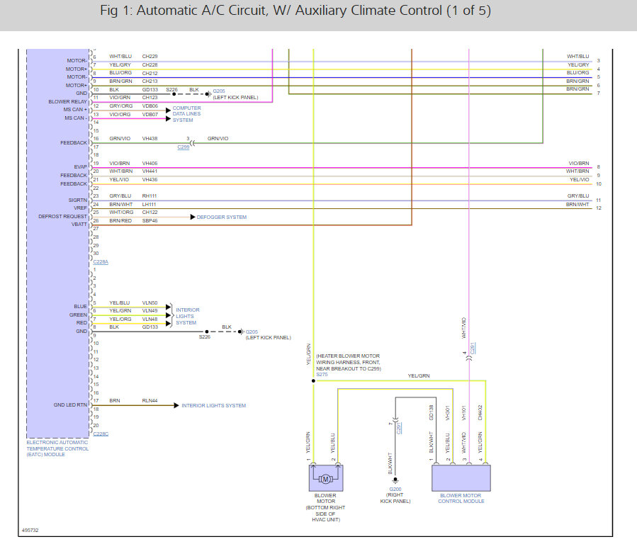

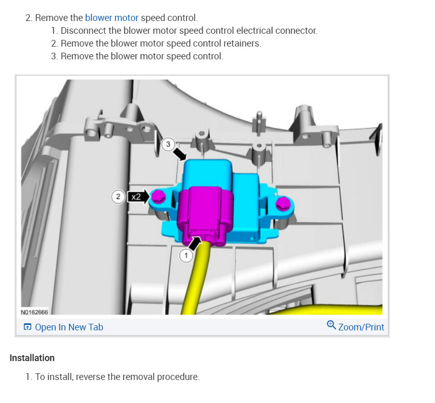

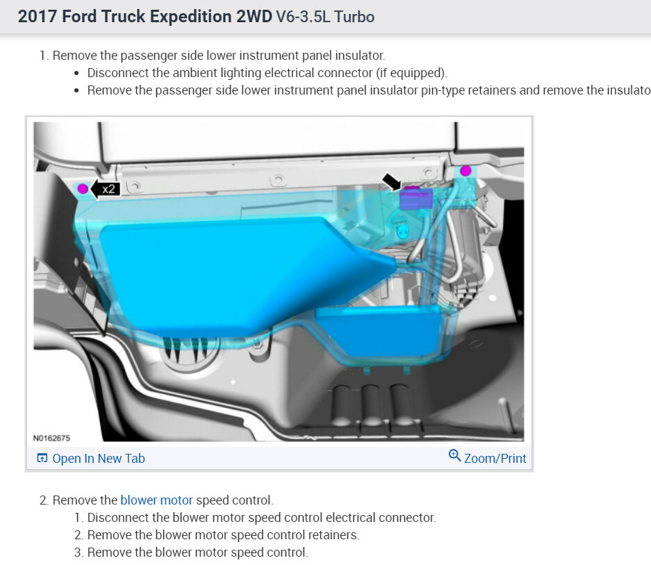

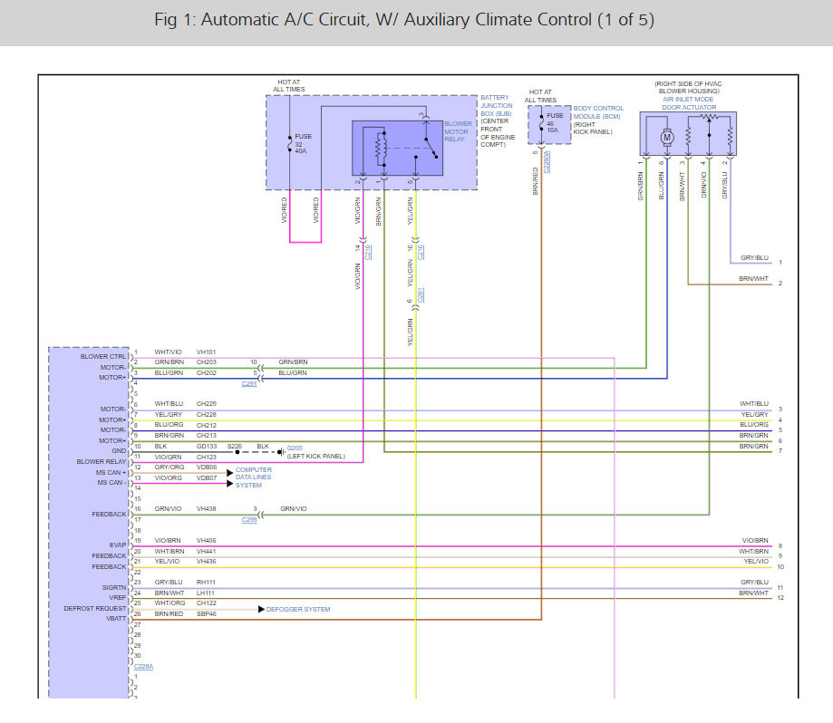

Here are the blower motor wiring diagrams so you can see how the system works and the fuse location as well in the images below. When you say resistor, you mean the fan speed controller correct? Check out the images (below). Please let us know what happens.

I will check the fuses this afternoon. Yes, the fan speed controller as shown above is what I replaced.
