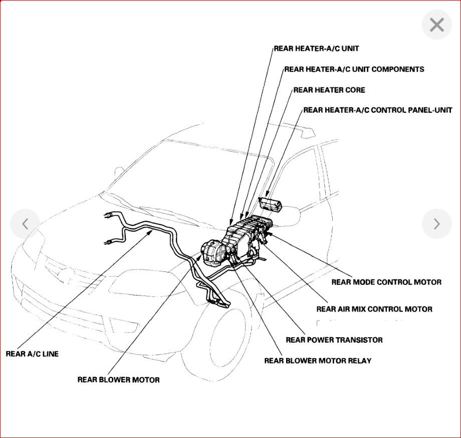

Hi, the front air blows hot air when the AC is on but the back still works and blows cold air. Previously when this would happen if we raised and lowered to temperatures to the extremes it seem to eventually work, but that bandage no longer useful. I’ve seen things about air mix motors or actuators, but not sure where to find that. One last thing, last year, my AC Front Blower motor went and I was able to replace it following some YouTube videos. This doesn’t seem to be the issue since air is blowing, it’s just seem to be warm as the engine warms up. Thoughts or suggestions?
Thank you!
Apr 28, 2019 at 4:35 PM

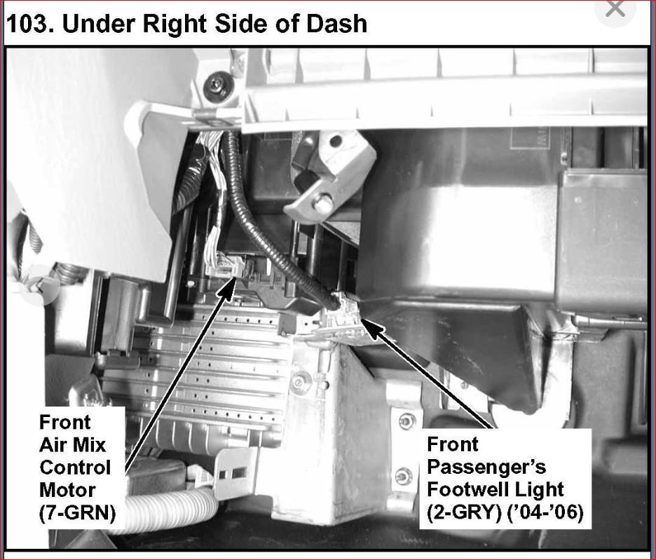

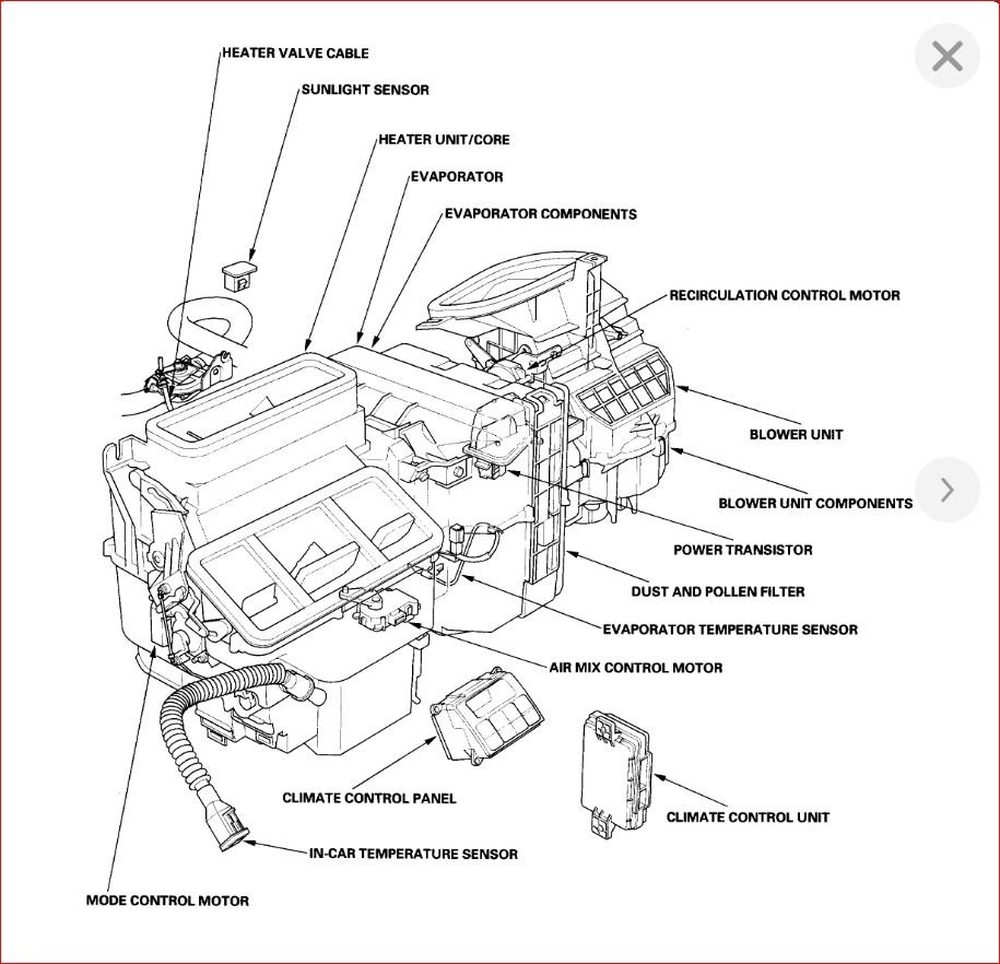

It could as simple as the blend door or air mix control motor is stuck or the gears are stripped. What happens is, when you change the temp this door moves and directs the air over the evaporator which cools the air. When this breaks/fails, the air is not directed over the evaporator so it is only passing over the heater core which heats the air and then it comes into the cabin. This is why when you used to raise the temp or lower it, the actuator would grab the gear again or unstuck itself and it would start working. Now that it does not work, most likely the gears are stripped and it can no longer move the door.
The rear works because it appears your vehicle has a rear system that is completely separate.
There is a chance that a temp sensor is reading improperly but based on what you described, the actuator makes more sense. We would need to hook a scan tool to the computer and see what the temp sensors are reading to rule this out. Again, it is unlikely because it appears this stays blowing hot even when you are not using the Auto setting. Normally we only use the temperature sensors to control heat/cool in the auto setting.

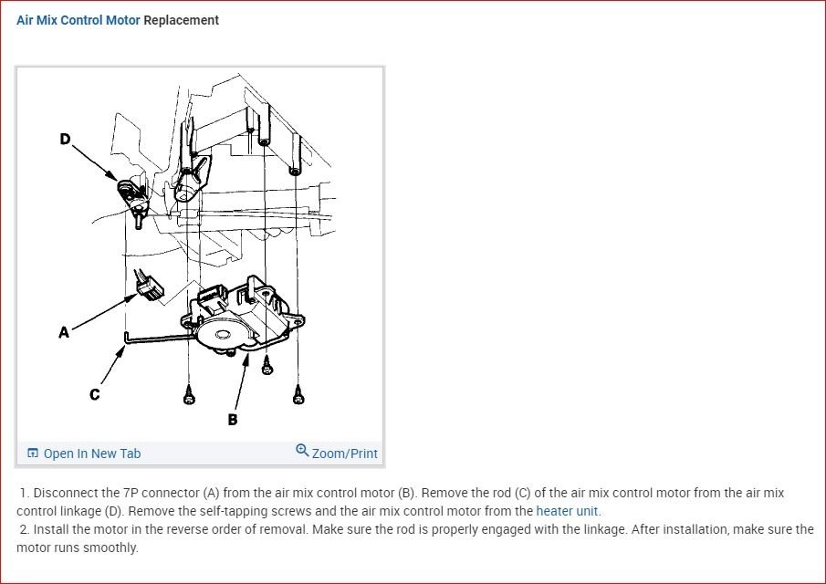

Thank you so much for your response. Do you have a video or more detailed pictures specific to an MDX? Is the blend door and air mix control motor two different issues? The link you provided is for a Blend Door Actuator. Is that the same as an air mix control motor? I also tried finding some parts with these names and the price varies so much, I got confused and not sure I'm searching for the correct part. I saw prices as low as $40 on Amazon and as high as $200+ in other places. Can you please provide some additional directions / explanations. Thank you.
Apr 30, 2019 at 7:13 PM
They are the same component. The blend door and air mix are the same thing just different names. The link I sent was just a generic guide to help explain this function.
Sorry for the confusion.
I just did a search for the MDX air mix door and found the same pricing spread. Basically the price difference is just the quality of the product. You can't really go wrong with this because they are just plastic gears so I would not be scared of the cheaper items. Just make sure they say they fit your year and model vehicle. Then they are for the air mix door or the blend door.
I could not find any more detail about your specific vehicle but here is a video from an Acura TL. It is a little different but these components are in about the same location but the operation is the same. I would verify the part number that is in the video to make sure it fits your vehicle but it is another option if it does. Clearly he made this video because he didn't want to pay the price. I am not sure you would be able to fix yours like he does but it may be worth while to take it apart and see. Worst case, you have to replace it.
Hopefully this helps. Please tell me what else you need and I will try to assist more. Thanks
