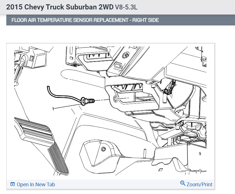

Front A/C not cold. Back works fine. Modes works we can switch to defrost etc., but the air is just room temperature. Freon levels are fine. The condenser was replaced due to a deer incident 6 months ago. Have checked drivers and passenger actuator and they are fine. What would be our next item to check?? Please help
Aug 13, 2023 at 4:07 AM
  • 55,433 POSTS

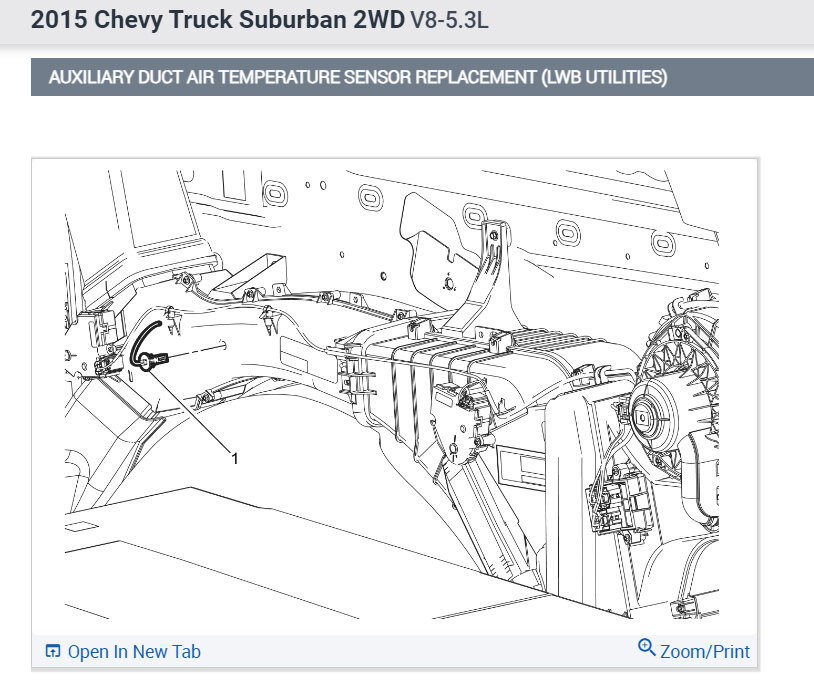

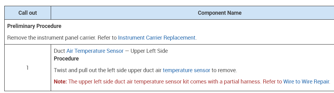

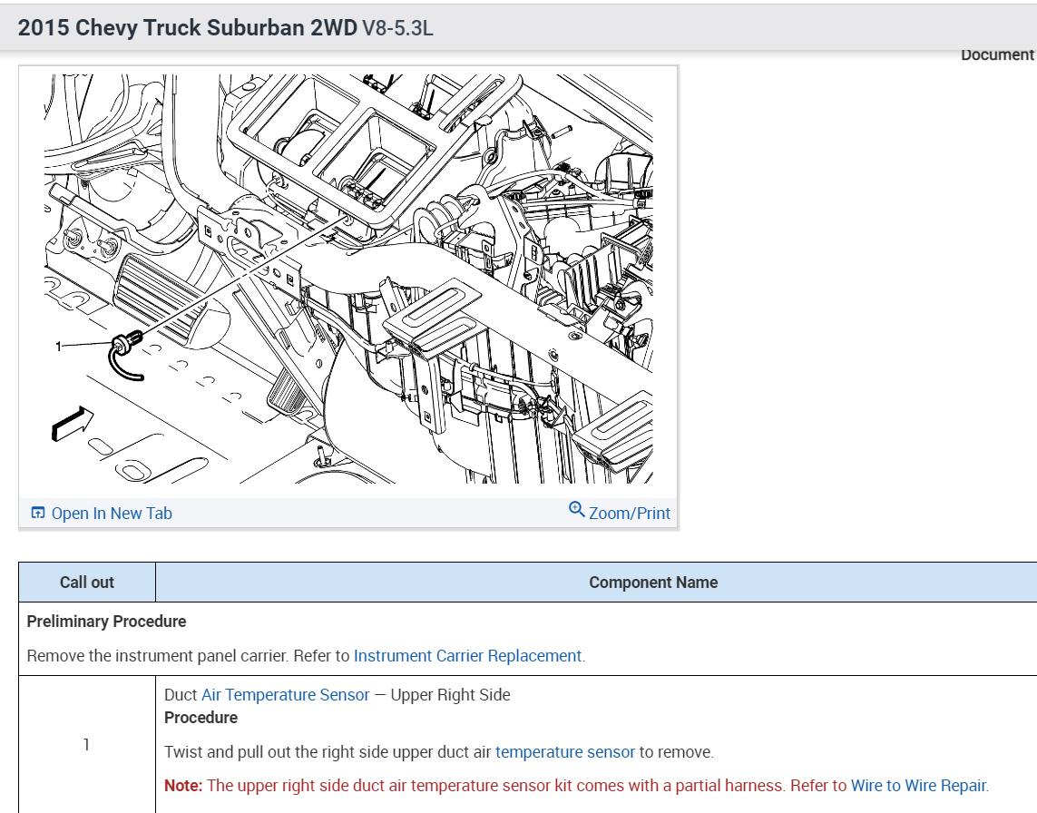

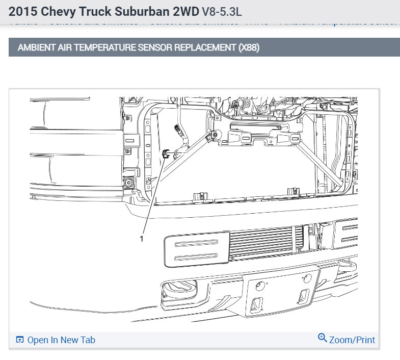

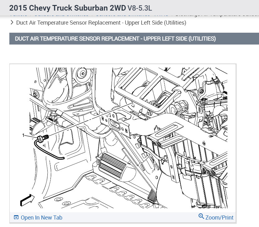

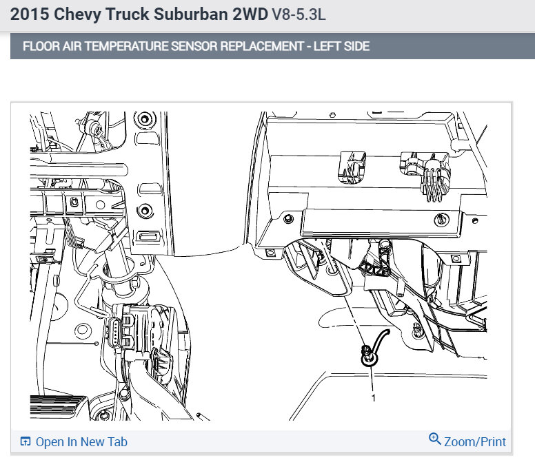

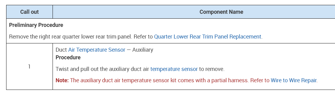

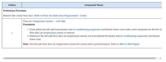

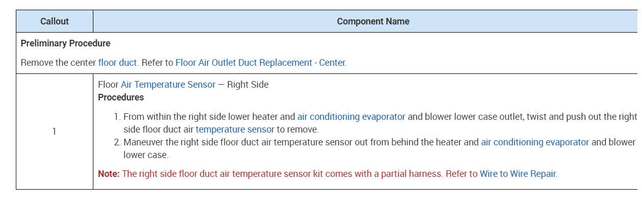

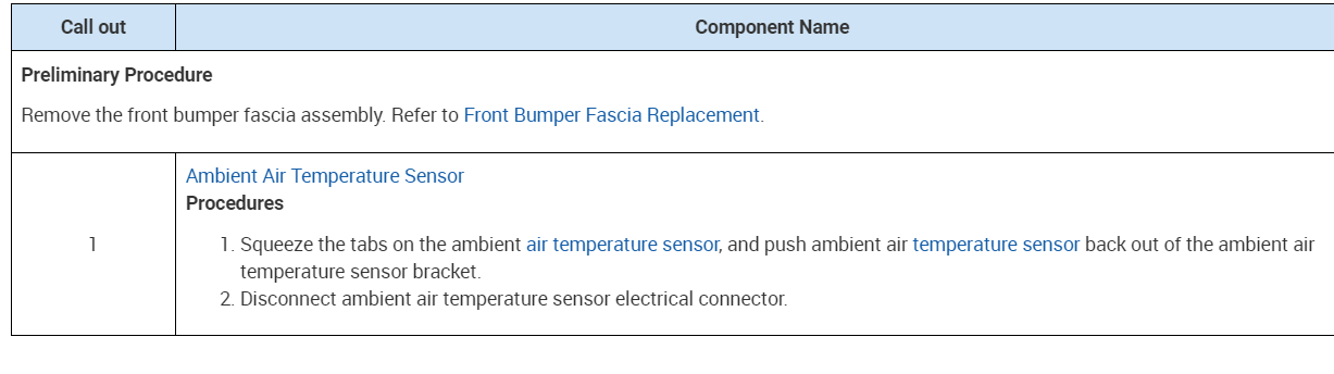

This is the third time we have had this problem on the site, can you please let me know what happens? I believe there is an air dust outlet temperature sensor that is bad or the ambient air temperature sensor is not plugged in or is bad, we should do a CAN scan which will go through the system and report back with any shorted or out of range sensors, you can get a CAN scanner (Controller Area Network) which will work on most cars from Amazon.
here is a video to show you how:
https://youtu.be/u-4syLc-ifQ

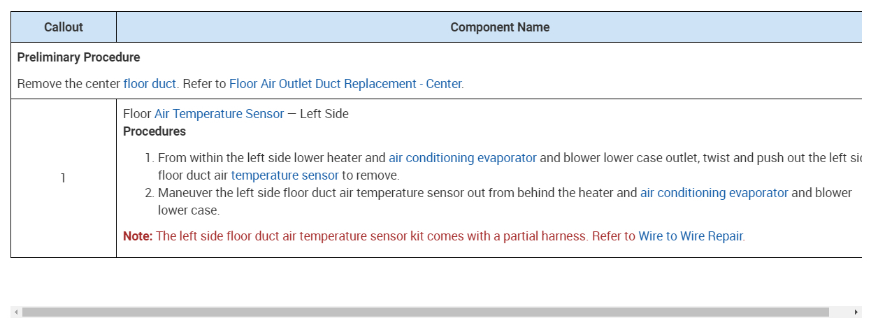

Here are the locations of the duct and ambient temperature sensor so you can check it out. Check out the images (below). Please let us know how it goes.

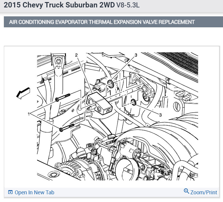

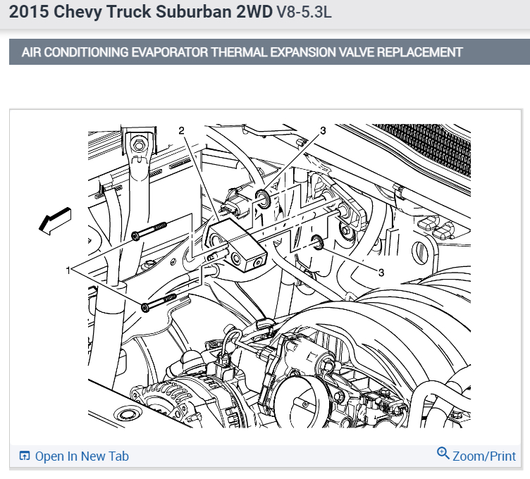

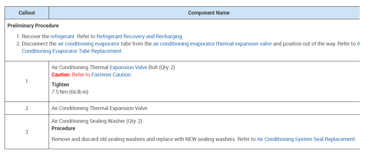

Hey!! Update. After scanning with snap on scanner. Still no codes. Finally figured out it was the evaporation valve. $25 part and it works great now!!
Sep 2, 2023 at 8:16 AM
  • 55,433 POSTS
Thank you so much for getting back to me :) so for clarification this is the valve you replaced? Check out the images. (Below)
