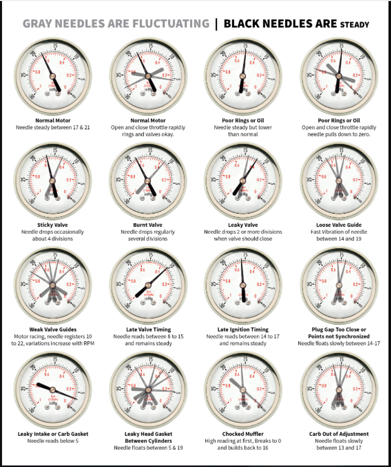

If there are no external leaks, then we need to monitor the vacuum of the engine by using a line off the intake manifold with a vacuum gauge.
Please see the chart below which will help with figuring out if we have the intake valves hanging open.
