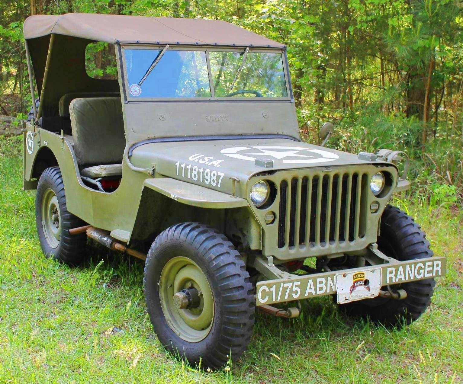

Ethanol fuel sort of separates it's water out when it sits still (this really rusted up my Jeep's fuel tank, when it sat idle for a couple of months awaiting parts)

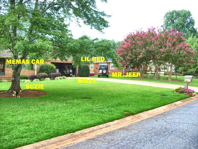

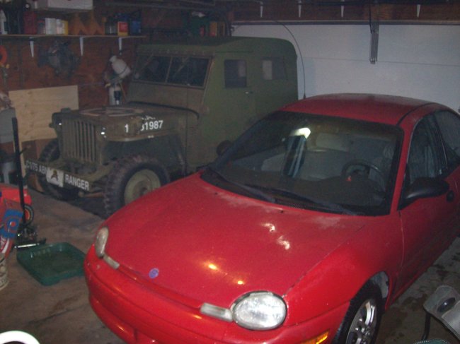

I am sort of basing this on the 1995 Neon I bought twelve or so years ago. I did not need it, it was too good a deal to pass up. Low miles/ Looked good/ Air worked/ 30 MPG. I gave $250.00 for it. I figured it would make a good spare car should one of the daily drivers fail to crank up. Unfortunately the step-daughter was "lent" 'Lil Red" until she could repair her vehicle. (This took her four years!)(what the heck, free car with insurance!) In four years time, I can say he still gets 30 MPG and runs fine. All of the original adjectives are out the window!
I found that two weeks was stretching it a bit, five miles did not charge the battery enough. Now it is take Suzie (My Beagle) for a ten miler once a week!
