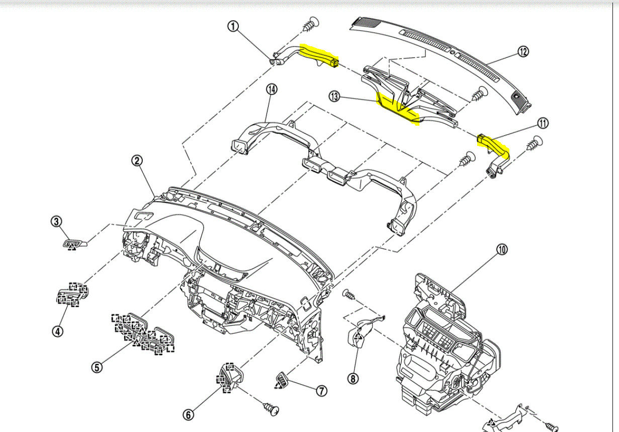

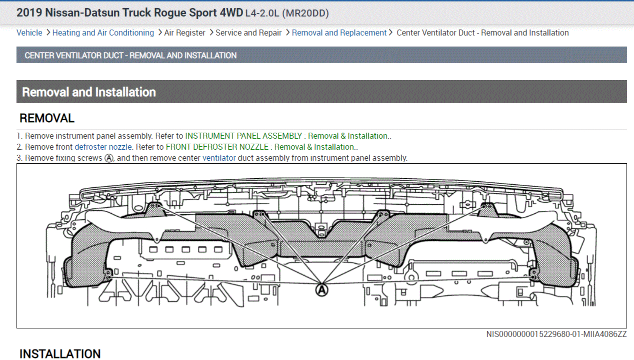

I attached an exploded view and highlighted the air ducts for side defrost and the W/S. Pic 2 shows how to remove the center duct, which requires the removal of the instrument panel.

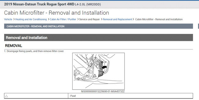

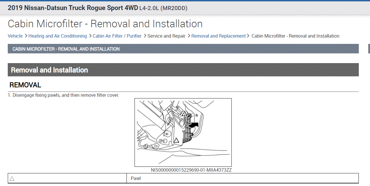

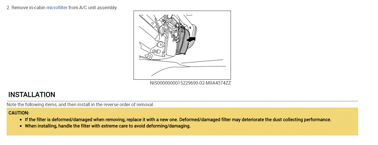

Also, I want you to remove the cabin air filter to see if by chance, you can see it. The cabin air filter is located behind the glove box. I attached directions below for removal and replacement. Remove it slowly in the event it got to that point. We don't want it to drop further.
Let me know if you can hear it and if you can see it from the cabin air filter.
See pic below.
