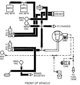

i was changing spark plug wires and now there is some vaccum hoses I can`t see where they belong it came loose when I was trying to change wires. ican hear vaccum suction when I turn it on and it wants to cut off on me. I just cant see back there

Hello and thanks for the donation! See if this helps you out..
https://images.2carpros.com/forum/automotive_pictures/261618_Noname_725.jpg

Emissions vacuum hoses top of the engine near the intake manifold.
The Originals became brittle and broke apart in many areas when intake manifold was removed to clean the intake port holes which are known to build up with residue.
I purchased new tubing which I will be cutting and installing once I know the diagram to route of each vacuum line. Example , Canister Purge Solenoid , EGR Vacuum Solenoid
Sticker under the hood is non neither readable nor gives clear specifics to rote.
Auto parts store who once had this posted on their web site, removed it from there data base .

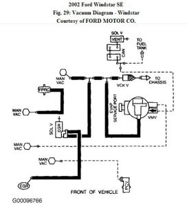

https://images.2carpros.com/forum/automotive_pictures/261618_Noname_2039.jpg

what does the vacuum hose from the pressure regulator got to?
Jul 31, 2019 at 4:48 PM (Merged)
  • 75,992 POSTS
It goes to a fitting on the intake manifold so that the pressure regulator receive full manifold vacuum to control fuel pressure.
