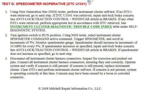

On our van, the Speedo only goes up to about 30mph then gets stuck there. The kicker is when it rains or is damp....it works. I feel that possibly the moisture is completing a circut somewhere. The ABS light has the same issue. When it rains it goes off. Can you possibly help me with this??

Hi cvalvo, Thank you for the donation. The speedometer and ABS are related and if one fails, the other would not work. I would suggest getting a scan done to retrieve the Diagnostic Trouble Code to facilitate rectification. Scan can be done free ant your local Autozone or Advance Auto parts lutlet. Here are the testing procedures.
https://images.2carpros.com/forum/automotive_pictures/192750_DTCu1041Speedometer01Windstar_1.jpg
Let me know what you have and I will assist in getting the problem solved. I believe it should be a wheel sensor problem
