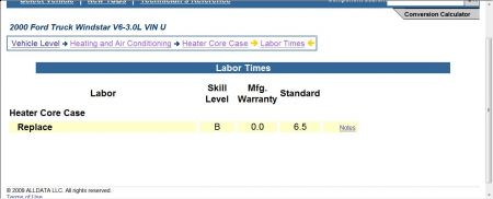

A service manual will tell you more on removal than a repair manual. I've check on Mit1 and Alldata for removal procedures there's nothing all I got is below
https://www.2carpros.com/forum/automotive_pictures/12900_windstar_heater_core_1.jpg
https://www.2carpros.com/forum/automotive_pictures/12900_windstar_heater_core_2_1.jpg
