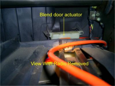

I have no heat in the front of my van. Blower is working fine but I only get cold air. Sometimes when I first start the vehicle I get a clicking sound and the rear blower will go off and on by itself. I replaced the thermostat since it is a quick and cheap repair but it did not help. I also felt the hoses running to and from the heater core while the motor heated up and they warmed up nicely so I believe the heater core is not plugged. From reading the questions on your site I am going to check the heater controls behind the radio and also check for vacuum leaks. Do you feel this should be my next step? Do you have any other ideas I should try?
The van is an LX and the rear heat works. The heater control valve behind the radio works when the controls are moved from hot to cold and there are no vacuum leaks elsewhere that I can tell. I am halfway to the heater core to see what the control valve turns when it is switched between hot and cold. I bought a Haynes repair manual and it does not cover much on this problem.
I had to run and spend another $7.00 just to buy a special tool just to get the radio out. I will check with AutoZone tomorrow on the code unless I can find the problem out today. I am also going to go ahead and flush the heater core after I tear half the front of the van apart to get to it. There is no room to do anything in this engine compartment.

Okay, I am going to give you information overload here since I am not sure what info your manual has. Then I will go back and review the manual, diagrams etc more in-depth and look at the TSBs as well but wanted to get this to you since you were already tearing into it.
First and biggest. . .. . .. . .. . .I did find this in our manuals. . .. . .. . ...Also please read all as I was going through our info I would find more tips etc. . .. . .. . .so please read all first.

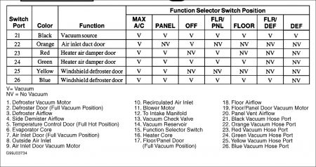

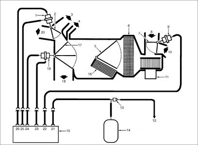

VACUUM CONTROL MOTORS
Main vacuum control motors are located on evaporator case. A single-diaphragm, 2 position, vacuum control motor is used for air inlet door. With vacuum applied, motor shaft is fully retracted and with vacuum not applied, motor shaft is fully extended.
Dual-diaphragm, 3 position, vacuum control motors are used for windshield defrost door and heater air damper door. With vacuum not applied, motor shaft is fully extended, with vacuum applied to one port, motor shaft is at center position and with vacuum applied to both ports, motor shaft is fully retracted.
Auxiliary vacuum control motor is located on evaporator case. A single-diaphragm, 2 position, vacuum control motor is used for air outlet door. With vacuum applied, airflow will be directed through A/C evaporator and out belt line and overhead register. With vacuum not applied, airflow will be directed through heater core and out rear seat airflow duct.

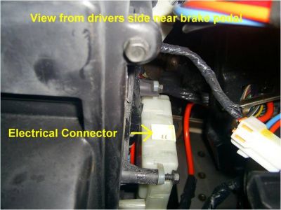

BLEND DOOR ACTUATOR
Removal & Installation
Remove radio. Remove left side instrument panel isolator. Disconnect electrical connector. Remove 3 actuator attaching screws. Pull down to release actuator shaft and remove actuator. To install, reverse removal procedure. Make sure door shaft is completely in and properly seated.
Tip: Blend Door Actuator Removal

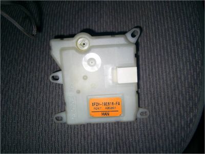

Had 2 Windstars this week with broken Blend door actuator.
Concern:
No hot air from HVAC. Clicking noise from dash area. Fan Speeds work normal.
Suspect:
Electric blend door actuator, Common problem that many techs have seen before.
Repair:

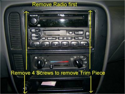

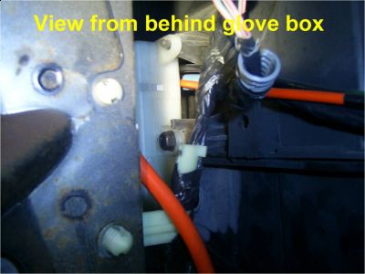

Remove radio ( special U shaped tool required Part # Unknown) Or other techs have used metal shirt hangers.
Remove radio and A/C Heater Control head. (4 screws 2 at top of radio 2 at either side of ashtray)
If van has aftermarket radio and you can not get the radio out easily, you can remove by swinging down glove box and removing 1 screw there and the 2 others screws from drives side brake and gas pedal area.
See attached pictures.
Remove 3 screws securing Blend door actuator.

System airflow is controlled by a 6-port vacuum selector valve, an integral part of control panel. System air temperature is manually controlled by temperature control switch, which controls electric-actuated temperature blend-air door.
Blower motor electrical circuit uses ground side switching with blower switch and resistor assembly on ground side of motor, not battery side. This protects resistor assembly from overheating in the event of an electrical short.
During system operation, with function selector switch in any setting except off and MAX A/C positions, blower motor and wheel draw air directly into system through cowl air intake. In MAX A/C position, air flows from inside vehicle through recirculation duct. Once in system, air is blower driven through evaporator core and, depending on setting of temperature control switch, through and/or around heater core and into plenum. Air is directed from plenum to defrost nozzles, floor and instrument panel registers, depending on position of function selector switch.
AUXILIARY A/C-HEATER SYSTEM
Auxiliary A/C-heater system, if equipped, is controlled by main A/C-heater system. Auxiliary system is equipped with 2 blower control switches (front and rear-mounted). If front auxiliary blower control switch is set to "0" (off) position, auxiliary A/C-heater system will be off.
If front auxiliary blower control switch is set to any fan speed, air will be discharged from rear vents at the corresponding speed. When front auxiliary switch is in REAR CTRL position, fan speed can be controlled from rear auxiliary blower control switch.
CONTROL PANELS
Function Selector Switch
The function selector switch actuates a 6-port vacuum selector, which controls air source intake and air distribution within system. The function selector switch also controls blower on-off switch and A/C compressor clutch operating circuit. The following function selector switch settings affect air distribution:
MAX A/C
The A/C-heater air inlet door is closed to outside air. Air from passenger compartment is drawn through recirculation opening and blown across evaporator core, past closed doors to floor and defrost outlets, and out through the dash panel. Air blown across evaporator core can be diverted across heater core, using temperature control switch, to warm air. A/C compressor and blower motor will both be operating when MAX A/C is selected.
Normal A/C
Airflow follows same course as in MAX A/C mode, except A/C-heater air inlet duct door is set to draw outside air instead of recirculated air. A/C compressor and blower motor will both be operating when normal A/C is selected.
Floor
Outside air is drawn into system, blown past evaporator core and through heater core. Windshield defrost door is in vacuum position, and heater air damper door is in no vacuum position. Airflow is directed mostly to floor outlets, with a small amount going to the windshield and side vents. Blower motor is operating.
Vent
With function selector switch in vent position, outside air is drawn into system and blown past evaporator core. Depending on blend-air door setting, air then by-passes heater core and is directed past vacuum-closed heater air damper door. Air temperature can be heated to more than, but not cooled to less than outside air temperature. In vent position, windshield defrost door is closed by vacuum to defrost outlet, and air flows through panel outlet and ducts to instrument panel registers. Blower motor is operating.
Floor/Vent
With function selector switch in floor/vent position, outside air is drawn into system, past evaporator core. The temperature blend-air door setting determines amount of input air heated by heater core and allowed to by-pass heater core.
The heater air damper door receives partial vacuum. As a result, this door opens halfway to allow airflow to floor and vent. The windshield defrost door is at full vacuum, closing off airflow to defrost outlets. Blower motor is operating.
Defrost/Floor
With function selector switch in defrost/floor position, outside air is drawn into system, past evaporator core. The temperature blend-air door setting determines amount of input air heated by heater core and allowed to by-pass heater core.
The windshield defrost door is in the middle position (vacuum to rear port), allowing airflow to windshield and floor outlets, with a small amount going to the side outlets. The heater air damper door is at full vacuum, closing off airflow to dash vents. A/C compressor is operating to dehumidify air and reduce windshield fogging.
Defrost
With function selector switch is turned to defrost symbol, vacuum to system is cut off. Temperature blend-air door determines amount of input air heated by heater core and allowed to by-pass heater core.
Heater air damper door is at full vacuum, blocking airflow to dash vents. Windshield defrost door is in the no vacuum position, directing most incoming air to defrost outlets, with a small amount going to floor and side vent outlets. A/C compressor will operate if outside temperature is more than 45-50 °F (5-10 °C), dehumidifying incoming air to reduce windshield fogging.

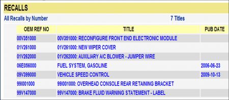

When I was searching threw the TSBs you do have one on the AC blower. . ...but it deals with the resistor heating up and smoking which isn't a problem you are dealing with.
However, it is under a recall. You actually have several.
The dealer may fix these for free. Please contact the dealer service department, give them the VIN number of your car and have them check on these to see if they apply to you.

I finally found my problem. After removing half my vehicle to get where I needed to go I flushed my heater core and hoses every way possible just to be sure and no blockage. It was a pain just to get to the heater core hoses, lotta parts strewn about the yard. I then removed the radio and heater controls and lower dash and peeked in at the Blend Door Actuator and it was working fine, turned nicely when activated and had good strength when held. So I decided to go further and remove the heater core (PAIN) and see if I could find something in the heater box and sure enough as soon as I lowered the bottom portion of the box a piece of plastic fell out.
The actuator was fine but the blend door was broken right where the actuator slides in. It was about a 2 inch triagle piece. I cannot even imagine how or why this would break but it has been a hard problem to track down.
I will have to drop the whole heater box to fix it so I used a coat hanger to prop the door open untill spring, probly not the smartest thing but I have had enough of this piece of Ford to last me awhile. I have a fun-filled weekend to look forward to this spring.
The pictures posted on this problem were perfect. Would be nice if Haynes repair manuals would follow suit.
Overall, I am sore, tired and ticked off because someone over-engineered this vehicle but decided to go with ultra cheap plastic instead of the cheap plastic.
The good thing is I now have heat and tools to remove a Ford Radio (really need to get a hose clamp tool also) and the heating system is flushed.
Thanks for the help and I hope this helps someone else.
