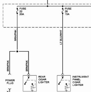

1995 Ford Windstar Cigar lighting diagram
ED WITKOWSKI
  • 1995 FORD WINDSTAR
  • 6 CYL
  • 2WD
  • 240,000 MILES
There was not anything in thr rceptical. The diagram would be a god send. Please help.
THANKS
edwit75@yahoo. Com
Tuesday, February 24th, 2009 AT 6:55 AM
JDL
  • 16,098 POSTS
https://www.2carpros.com/forum/automotive_pictures/170934_ford_win_1.jpg
Hello, that's a start, there is a black wire not shown in the picture, from the bottom of cigar liter, that's just a ground. The fuses shown are in the i/p fuse box, voltage to those fuses comes from the underhood electrical center.
