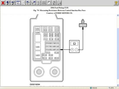

I dont have a fuse diagram for my truck and have no way of knowing if there is a transmision solenoid relay or anything to cause the transmission not to shift properly.when it gets to ovrdrive it goes to neautral .There was no warning .There was no slippage are anything to indicate a problem. I press the O/D off button and it runs like a rabbit.Are there any sensors switches relays or anything electrical that could cause it not to shift right ? Please and God Bless !Desperate and broke but Saved

YES! There are wires and solenoids in, and leading to, your transmission. This could be an electrical problem OR a mechanical problem. Is the 'check engine' light on? If so, what are the codes? That may lead you in the right direction. Let's start there. I'll be waiting for a repost if you get stumped... good luck...

here is a pic of the fuse box the relays and fuses but it sounds more like it is the overdrive selonoid
https://images.2carpros.com/forum/automotive_pictures/52960_123456_1.jpg
