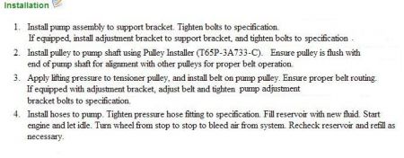

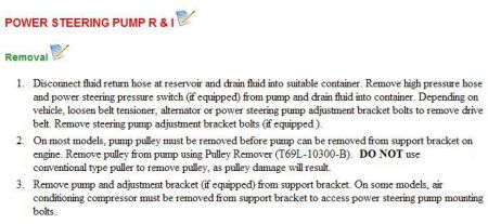

1994 Ford Truck removing power steering pump
1994 FORD TRUCK
PETER ERB
Steering problem
1994 Ford Truck 6 cyl Four Wheel Drive Manual
how do I remove the power steering pump - it is captive in the bracket and it appears that I must remove the pully however the pulley remover won't fit between the pully and the radiator cowling

https://images.2carpros.com/forum/automotive_pictures/261618_Noname_1137.jpg
https://images.2carpros.com/forum/automotive_pictures/261618_Noname2_327.jpg
