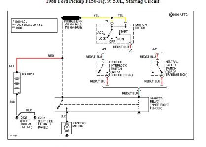

1988 Ford Truck no power at solenoid
1988 FORD TRUCK
ALASKIWI
Electrical problem
1988 Ford Truck Automatic
engine willl not crank.Replaced starter relaystill no power on output side of starter relay
Jul 17, 2010 at 11:31 AM
HMAC300
  • 48,601 POSTS
you have to make sure that your battery is in good shape first. Then with a test light make sure that power goes to the solenoid/relay. then activate to see if the test light stays bright when the relay is activated. if not, then it's probably not getting any power to do so. It could be a fusible link that is burnt up. also try wiggling your shifter, it may not be hitting the nuetral switch right. Also next time say what engine it is. I'm sending a diagram of hte starting circuit. it is the same for all engine in a pickup luckily.....
