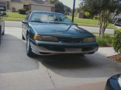

https://images.2carpros.com/forum/automotive_pictures/584303_my_new_car_1.jpg
40th anniversary model in the metal flake green - she is a beauty huh? lol
Oct 21, 2010 at 11:59 AM
SERVICE WRITER
  • 9,123 POSTS
Certainly hasn't spent time in Western New York!
Oct 21, 2010 at 12:22 PM
LAZYBONES1222
  • 18 POSTS
No - there would be nothing left but rust - Florida car. :)
Oct 21, 2010 at 12:42 PM
SERVICE WRITER
  • 9,123 POSTS
Ah contraie....There would be a bunch parts that are starting to rust because they rotted out 8 years ago and were already replaced lol....
