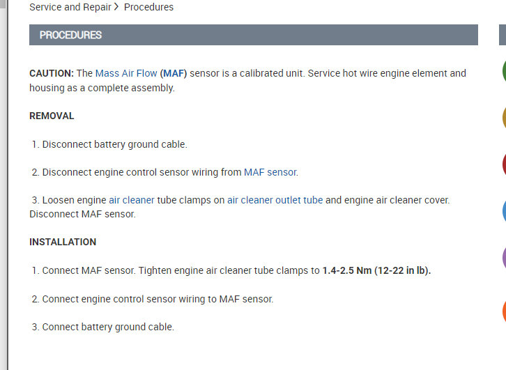

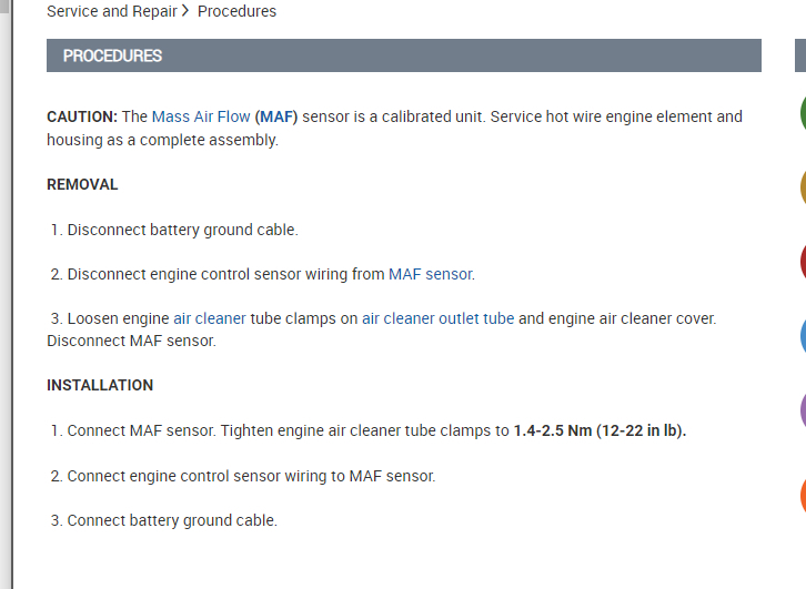

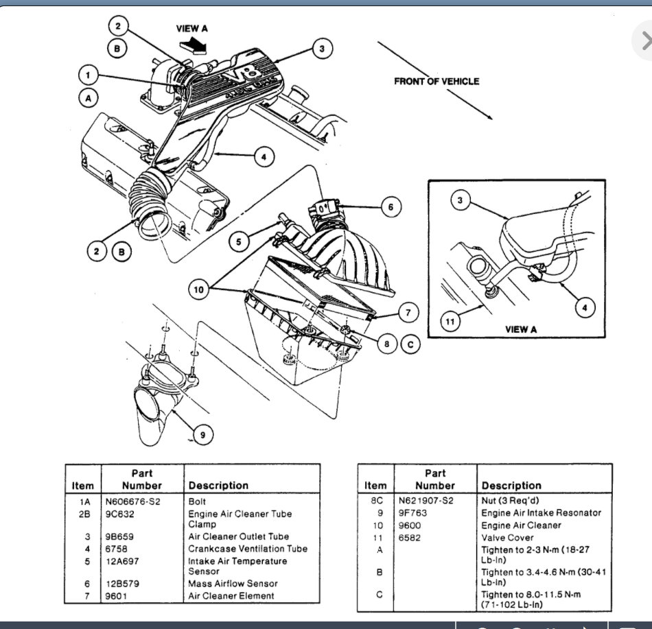

Below you will find the info on the MAF sensor. I would suggest unplugging it and driving the vehicle. If it seems to do better then I would clean or replace it.
Here is a guide that will show how to replace it:
https://www.2carpros.com/articles/mass-air-flow-service
Let us know what you find with this and we can go from there.
