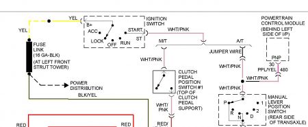

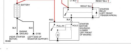

What is the proper wiring configuration for starter sloenoid
