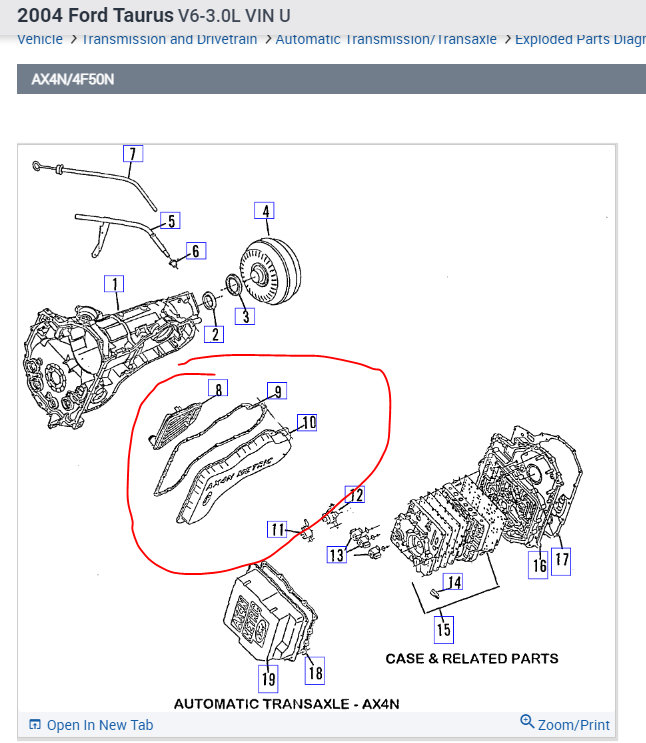

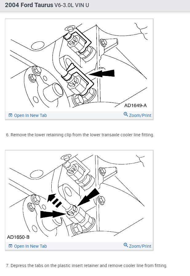

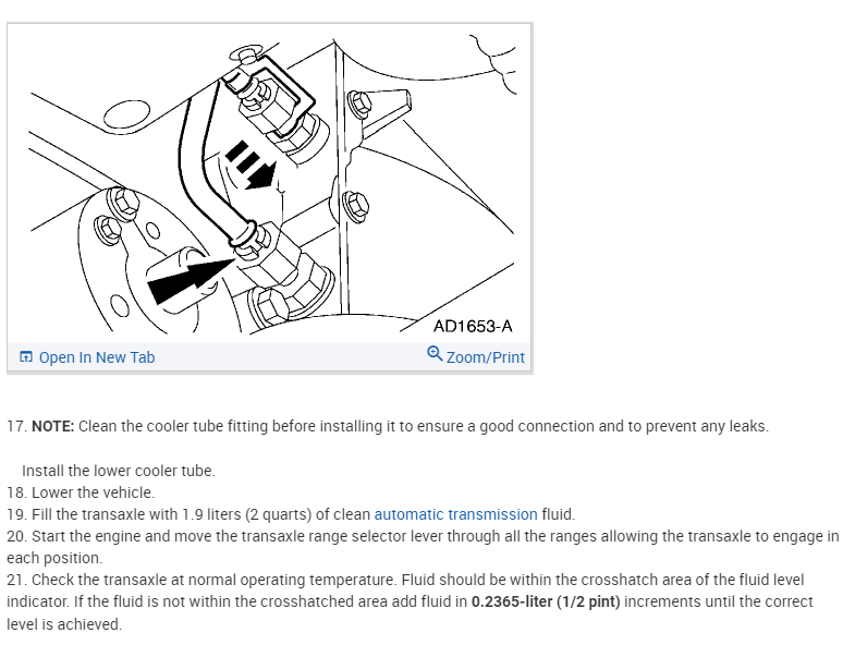

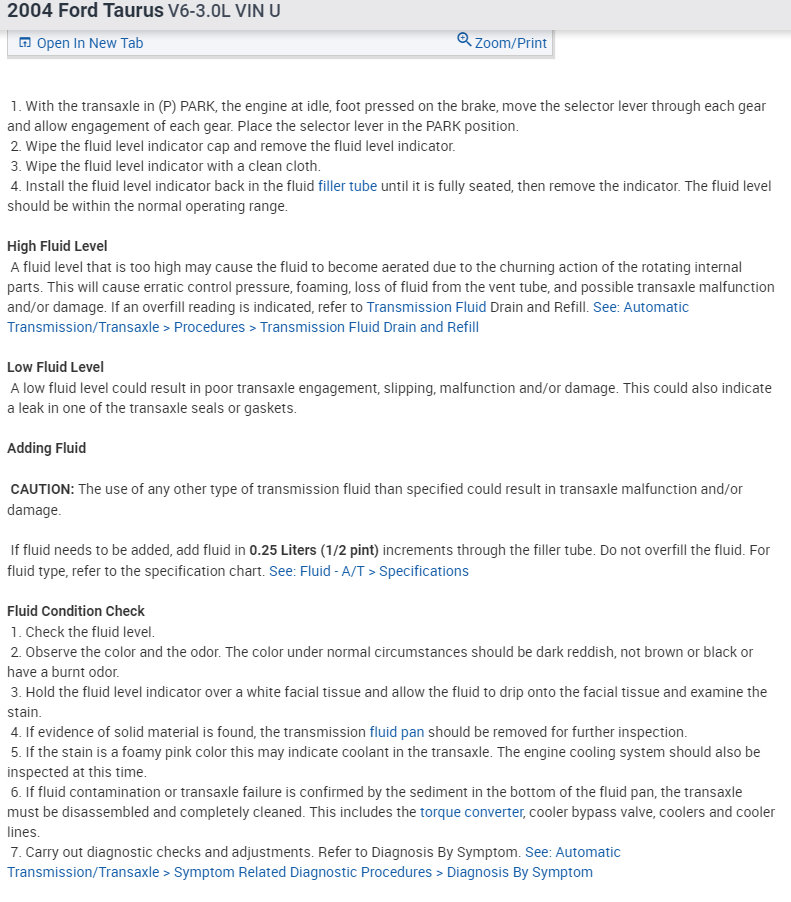

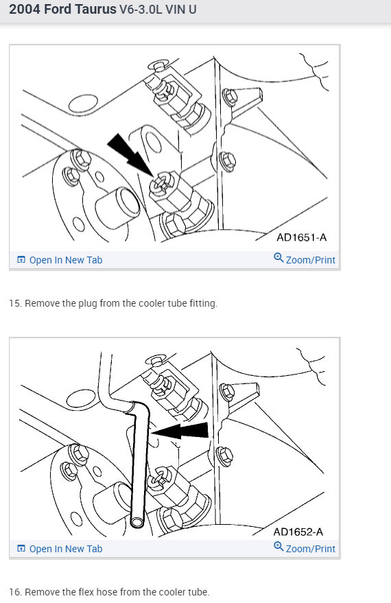

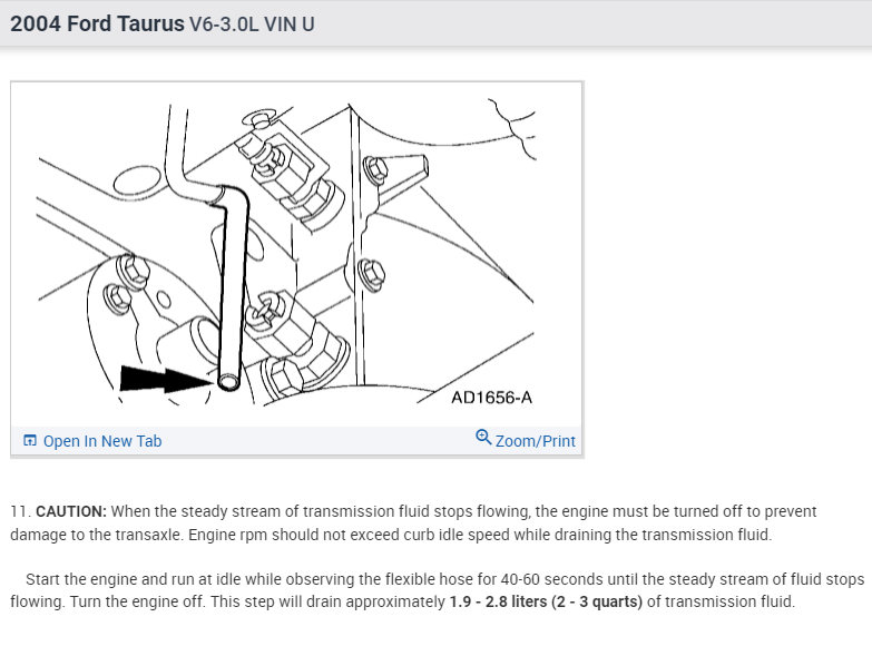

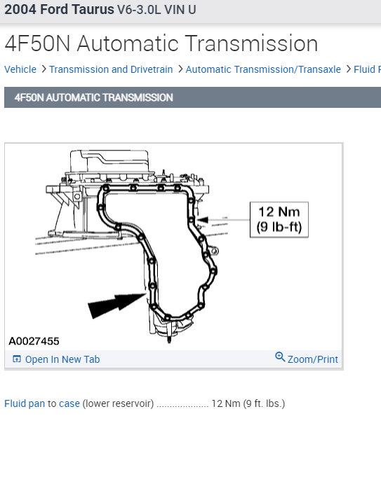

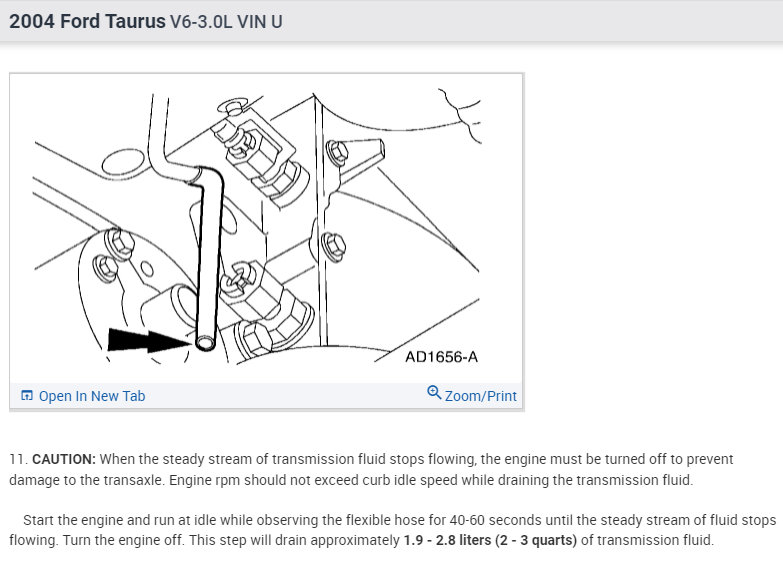

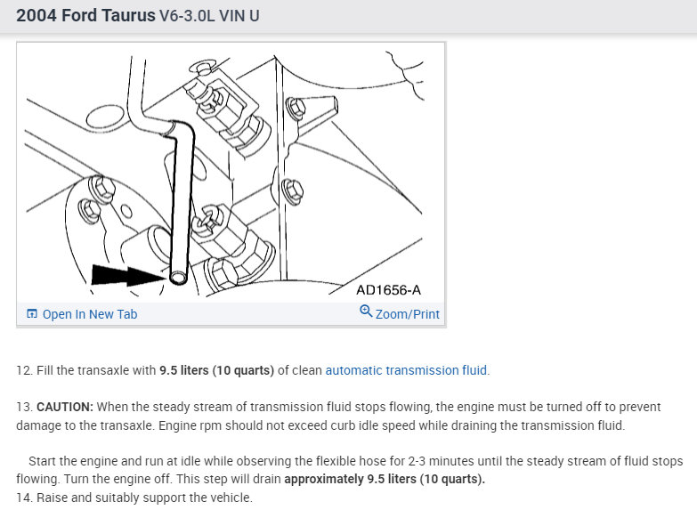

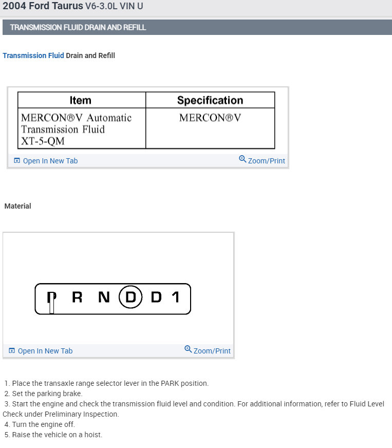

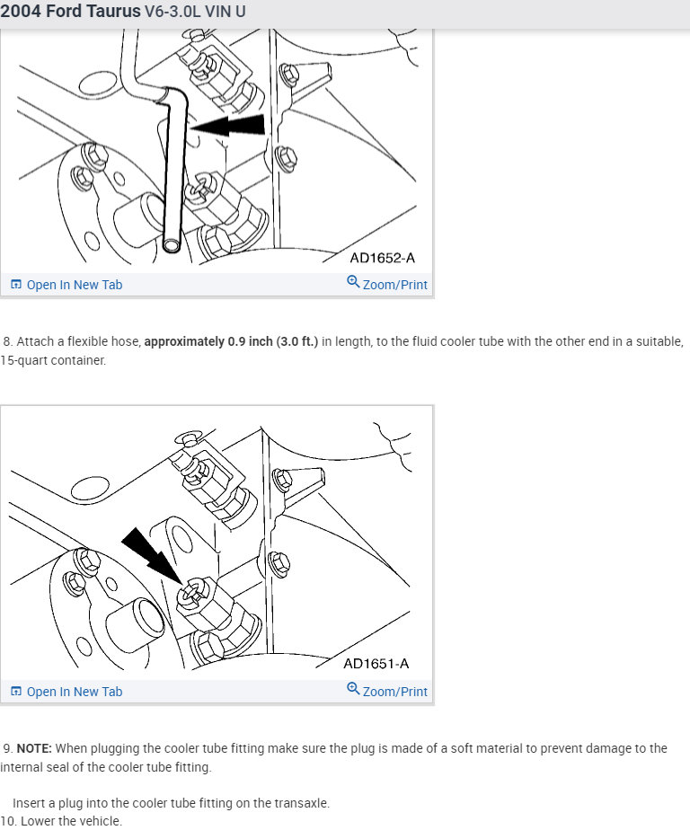

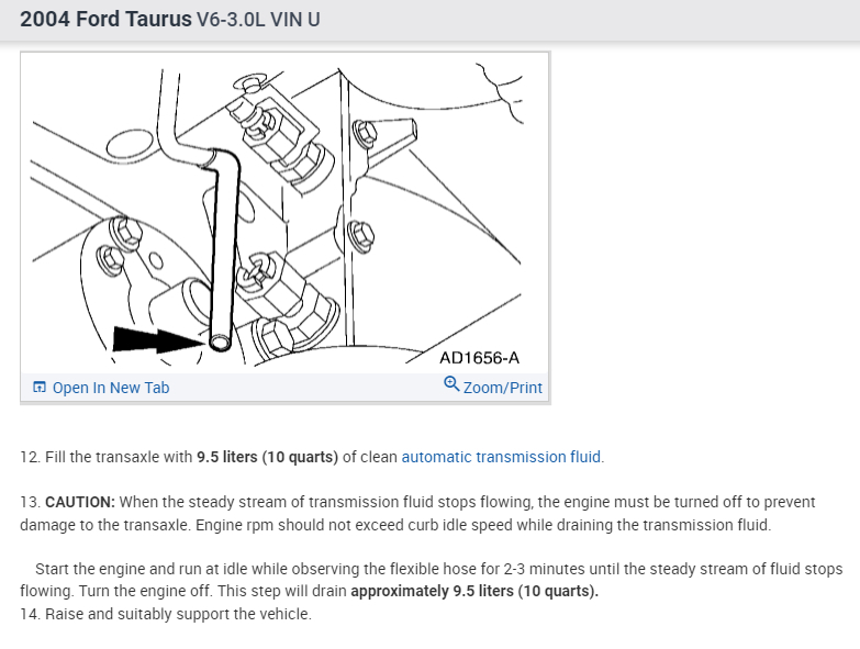

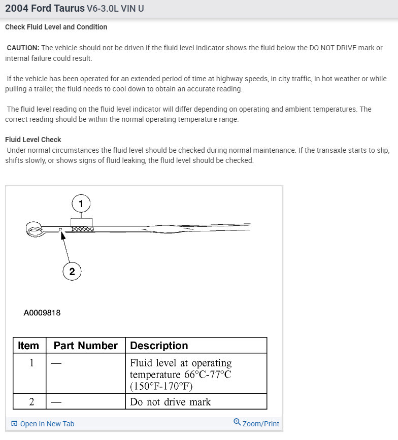

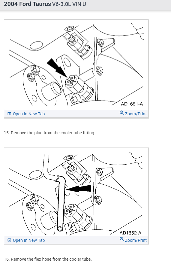

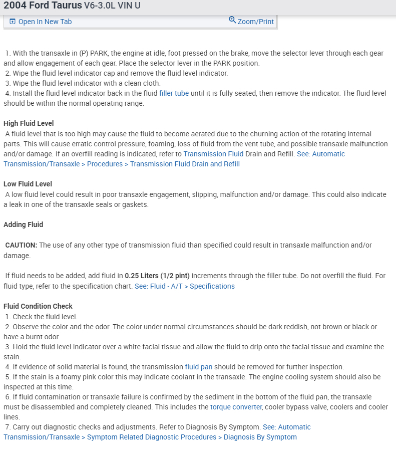

The transmission can be service easily on this vehicle.
This vehicle uses Mercon V Automatic Transmission Fluid.
First you will have to raise and support the vehicle on jack sands to get started.
Here is a helpful guide:
The transmission pan bolts need to be torqued at 9 lb. ft.
