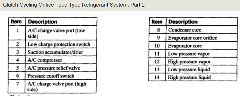

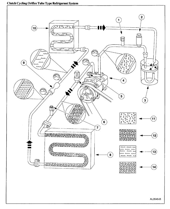

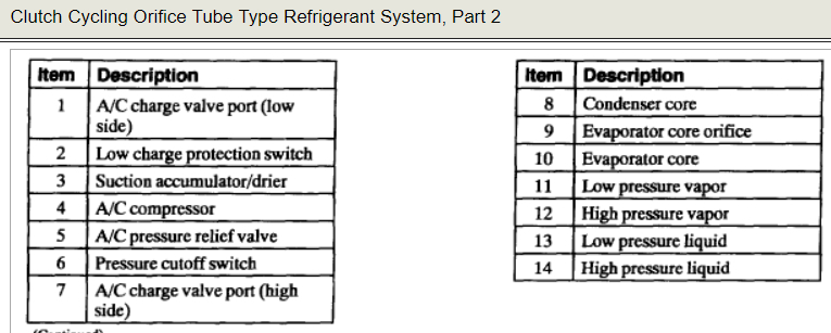

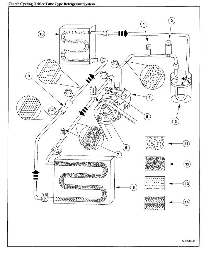

HMAC300
  • 48,601 POSTS

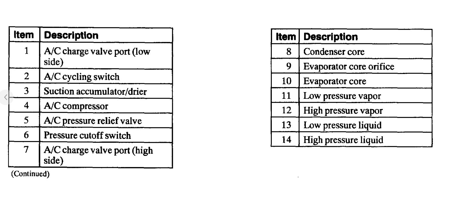

Sometimes the Low-Side port can be hard to locate.The low side are the larger of the two lines for the A/C system. Please see the attached diagrams and video to help you locate the service port. I have also attached a guide to help you charge the A/C once you locate the correct service port.
https://youtu.be/ON2dYcmXIAw
https://www.2carpros.com/articles/air-conditioner-how-to-add-freon
Please check out the attached videos, guides and diagrams, let us know what you find.

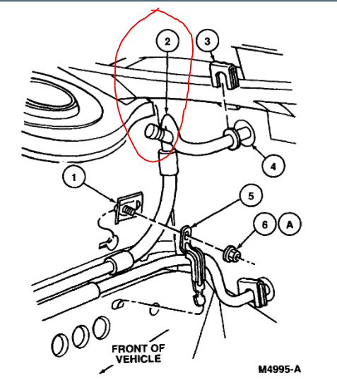

I need help finding the low pressure port so I can charge the system. I found the high pressure port but the low pressure is not in the same area.

Look at rear of engine compartment by the firewall on pass side down low. Should be there. Let me know.

I apoligize for not getting back to you sooner. Thats not the port. Thats for evap testing. Yours will be a black cap. The adapter is on the fatter of the 2 ac pipes.

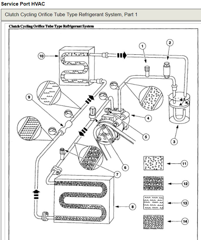

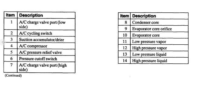

DANNY L
  • 5,648 POSTS
Hello, I'm Danny.
Here is a tutorial for you to view on how to add refrigerant to your A/C system:
I've added a picture below of the low side service port on your car and circled in red. Hope this helps and thanks for using 2CarPros.
