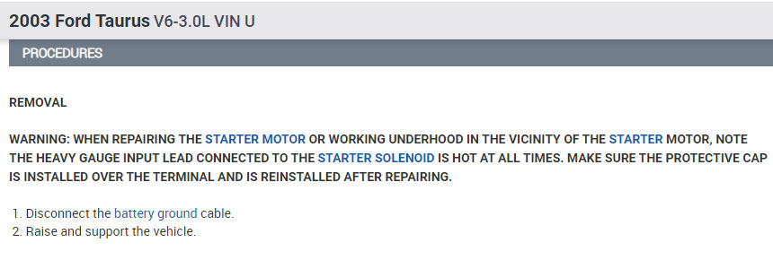

ok my car has been driving fine. i shut my car off and went inside my home for about ten minutes, when i came out and went to start my car it just went click click click and would not start. i thougt my battery had just died but i tried to boost it and it would not even try to turn over. all the electricals wont work unless my battery is hoooked up to something. Is my battery just completely dead or is there something more?
Mar 13, 2009 at 11:47 AM
DANNY L
  • 5,648 POSTS
Hello, I'm Danny.

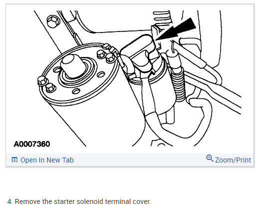

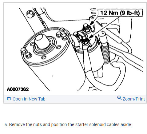

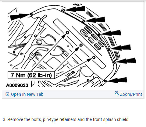

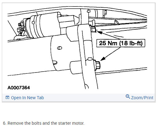

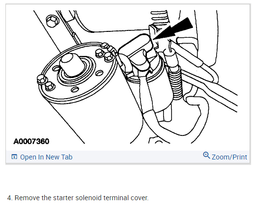

It sounds like you might be having an issue with the starter motor-solenoid. Here are a few tutorials for you to view showing the operation and replacement of the starter motor solenoid assembly:
https://www.2carpros.com/articles/how-a-starter-and-solenoid-works
I've attached picture steps below on how to replace the starter motor assembly on your Taurus. Hope this helps and thanks for using 2CarPros.
