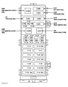

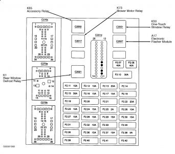

When fuse blows does that effect the blower fan
(no more air blowing too )
seen it where the blower motor over load the circuit and blows the fuse
if so disconnect the blower motor
replace fuse and run the system
if all ok replace blower motor
if not check wiring and what else the fuse protects
good luck
