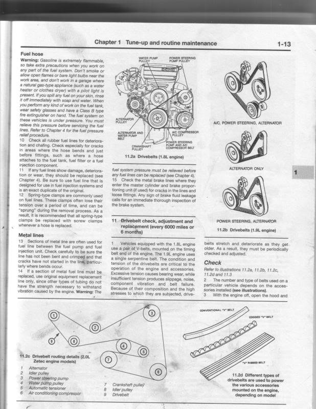

Serpentine belt, one pully is NOT turning any more. Looking from the passenger side of the car, the unit is on the right (front side of car) and on the bottom. It's held in place by three bolts in a triangle pattern. The belt is turning, but is dragging across this unit so it's starting to smoke and smell of burned rubber.
What is this unit?

Based on (see attached image)
It's the AC Compressor.
Ugh! $199 and doesn't look easy to replace.

Yes it is the A/C Compressor. And you would be better off taking it to a garage you trust. They will have to evac the system of all old freon before replacing the unit. You are probably looking at around $500+ for repairs.
