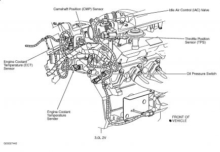

Oil light comes on after approximately 1/2 hour of driving.
Vehicle has oil in it. Engine does not sound or run differently.
It is with our daughter at college and I am trying to get an idea of what is wrong.
Thanks

I would suspect and replace oil pressure switch as a 1st step
if that didn’t help oil pump would be the next step

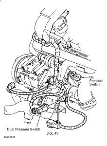

BMRFIXIT
  • 19,053 POSTS
I would suggest getting the new oil pressure switch it require a special socket it just twist off few turns and its out you can try deep sockets on the new switch if dont have the special socket you need to know engine size at the part store it should be priced under $20 for you to test oil pressure you need a set of special gauges remove oil pressure switch install in its place and start and drive the car watch oil pressure

STANDERSON
Took about 10 minutes of looking at the diagram, the engine, etc, to realize the diagram was showing the back of the engine, not the front.
Once I got it located, it was a five minute job.
