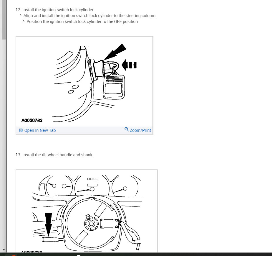

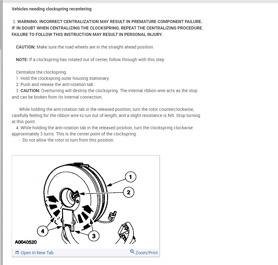

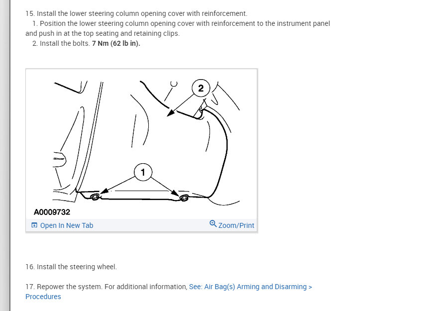

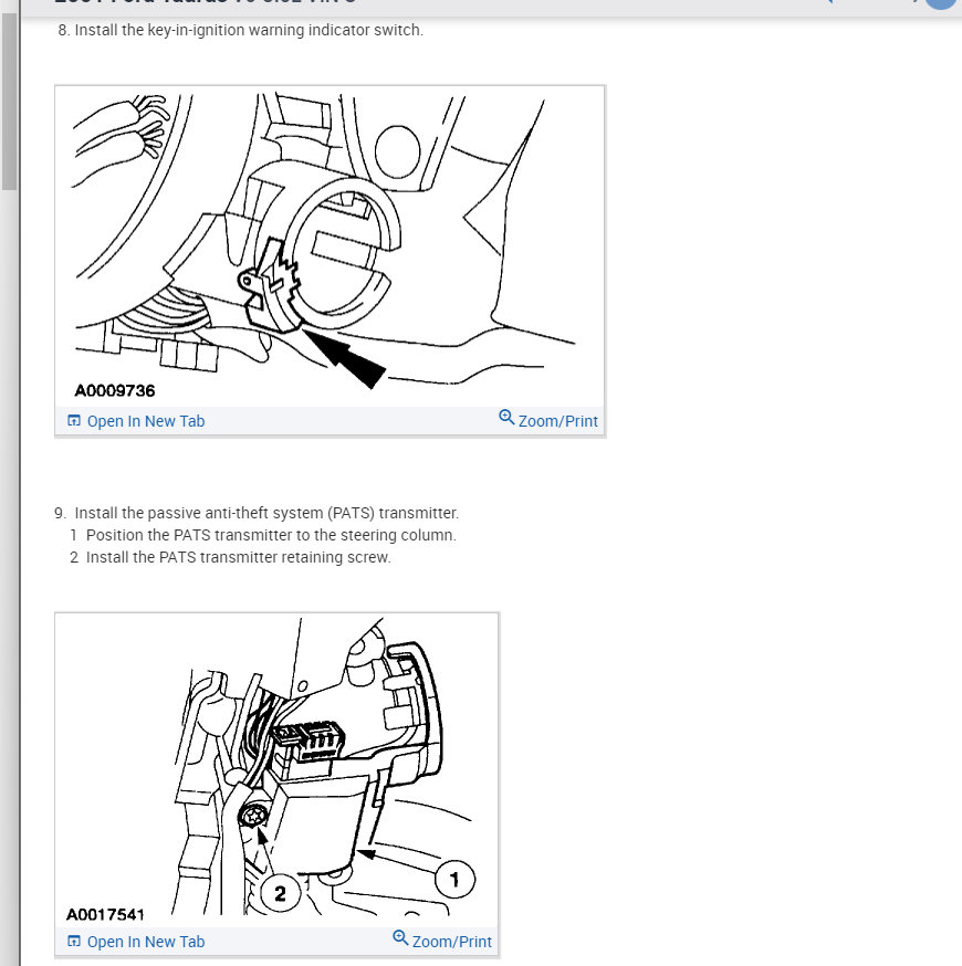

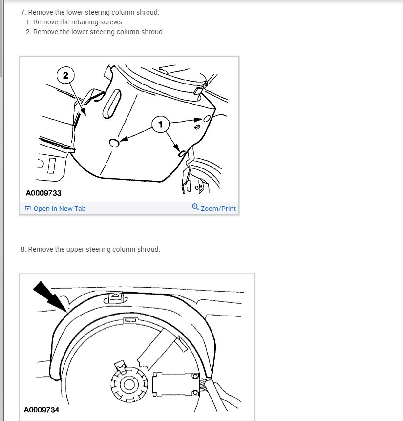

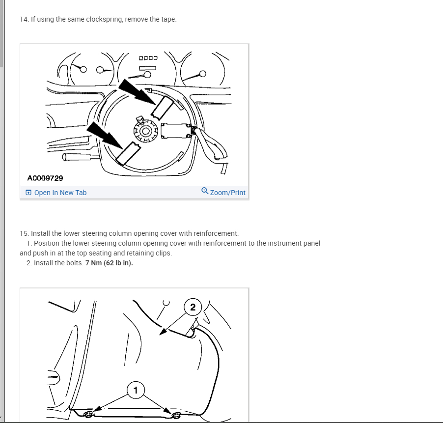

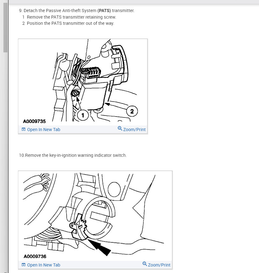

When I bought this car the horn and cruise control didn't work. When I checked it, the horn fuse was blown, the speed control fuse was fine. I replaced the horn fuse. Horn still won't honk, cruise control still won't even turn on.
Apr 6, 2008 at 6:09 PM
  • CAR REPAIR CONTRIBUTOR

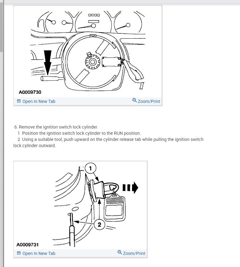

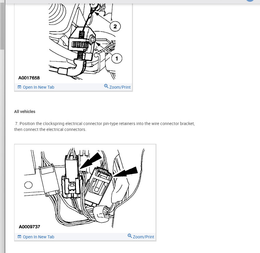

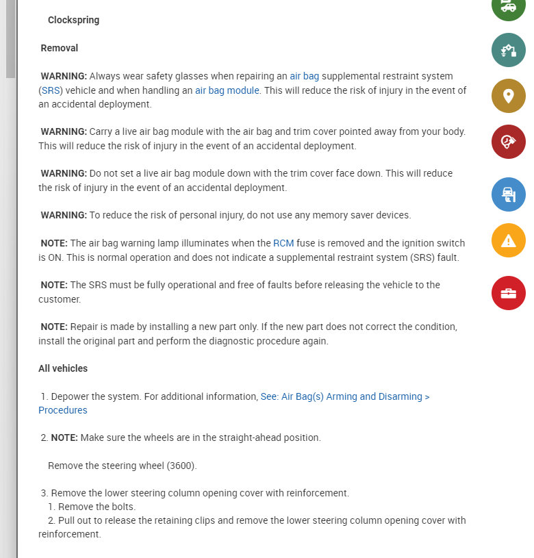

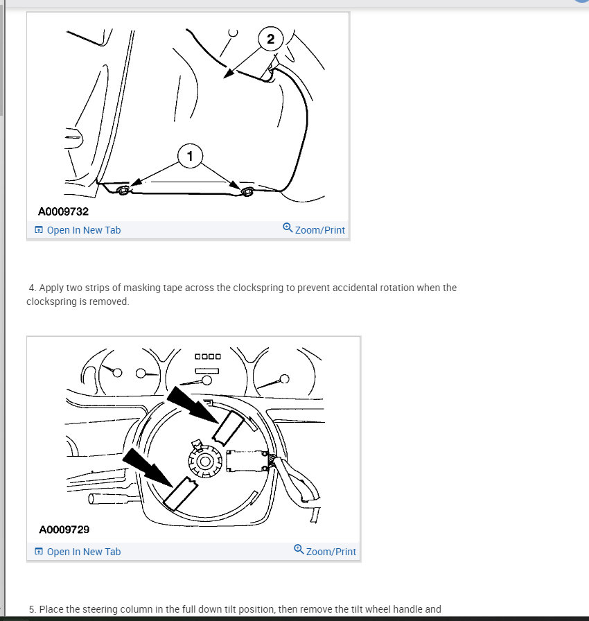

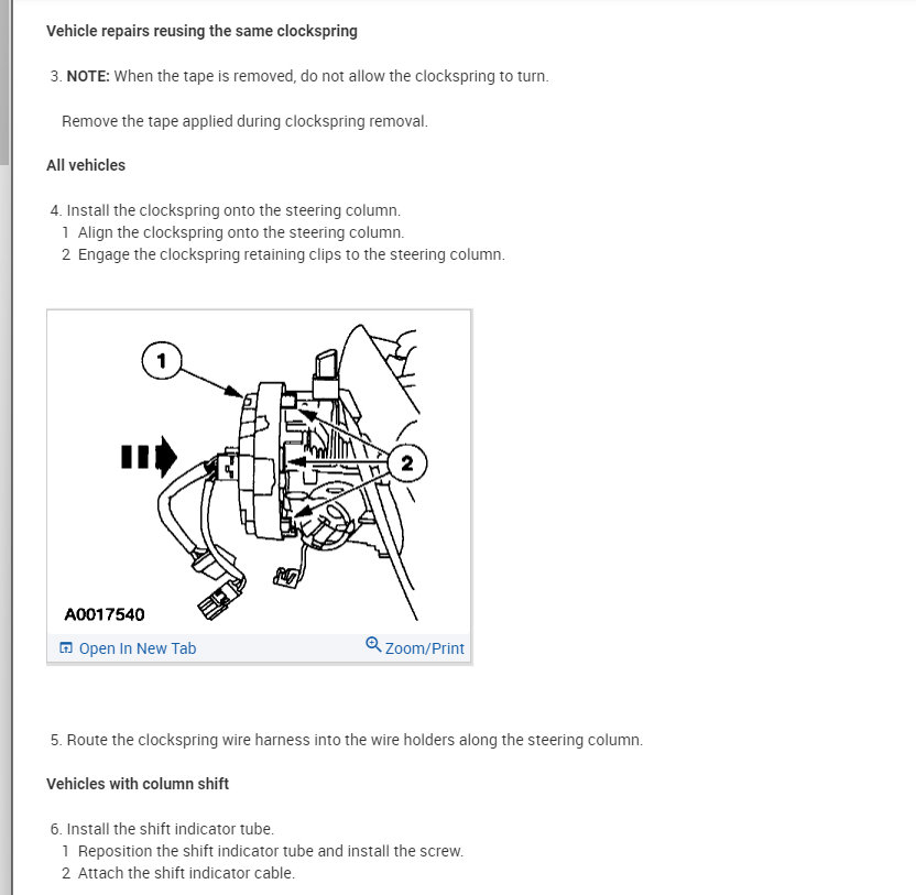

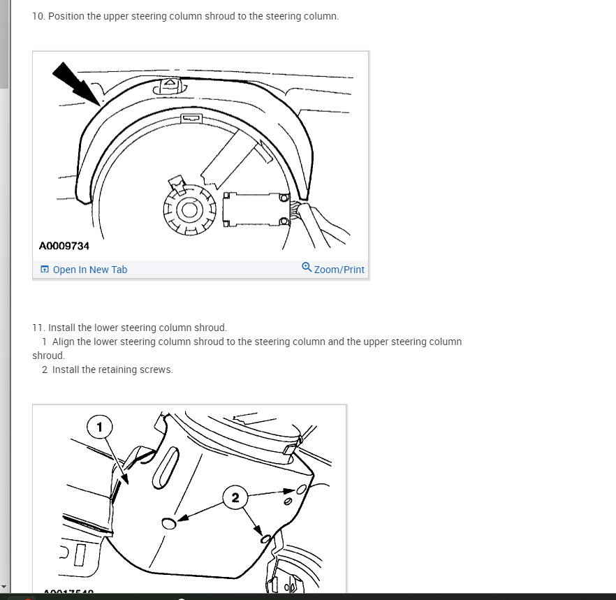

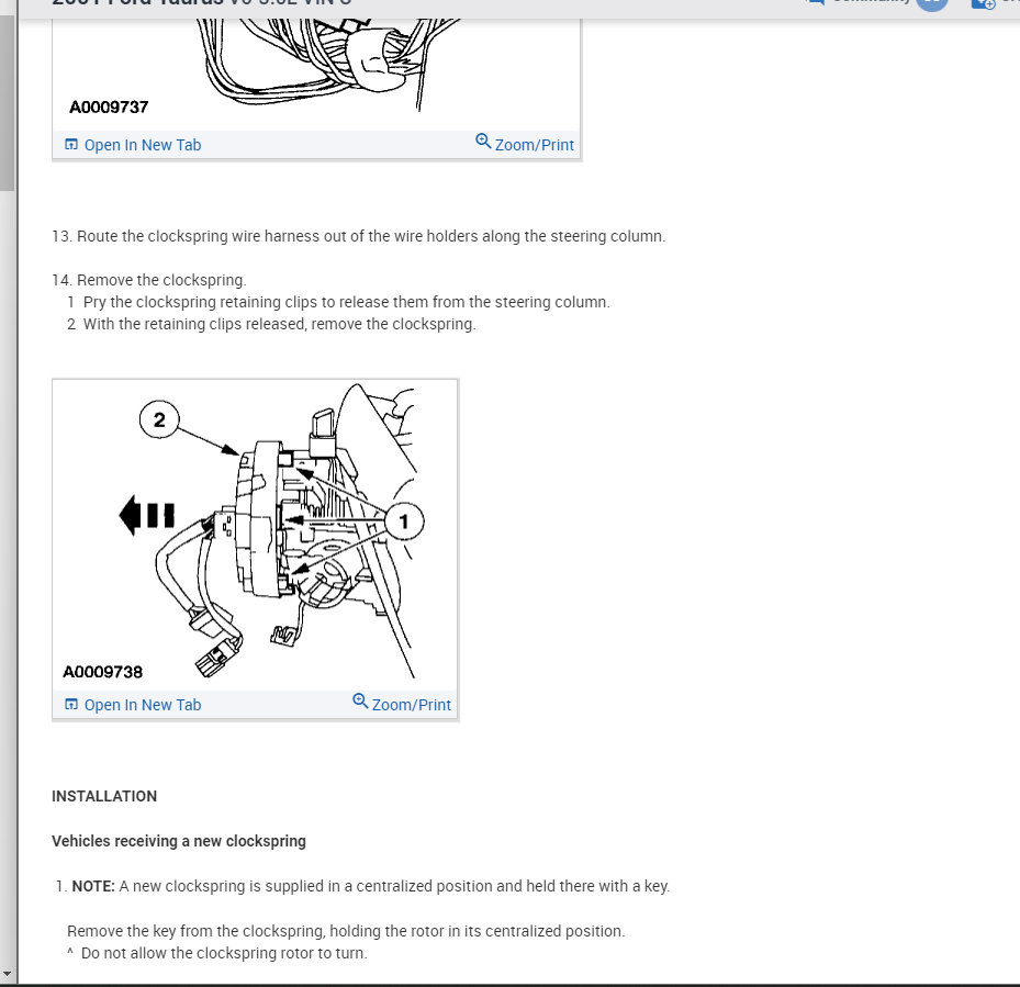

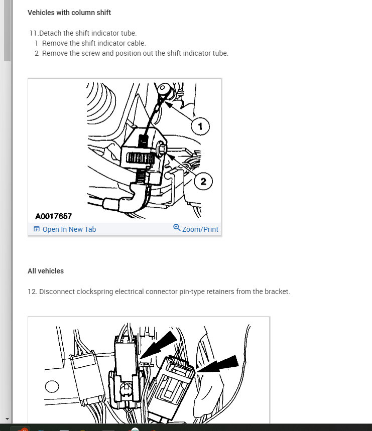

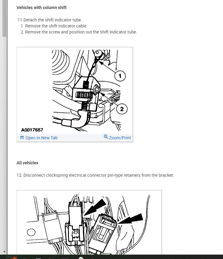

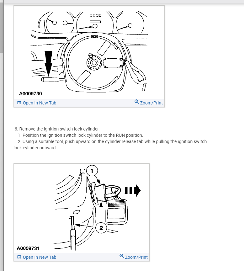

This could be a couple things, but the likely cause is the clock spring. Basically, this is a connector that allows
https://www.2carpros.com/articles/symptoms-of-a-bad-airbag-clock-spring
https://www.2carpros.com/articles/steering-wheel-clock-spring-removal
Please see the info below on how to replace this. Please run through this and let me know what questions you have. Thanks
