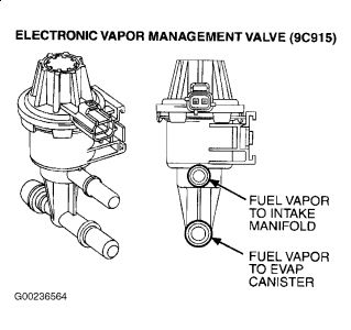

If you are experiencing a P0455 code but cannot find a leak you likely have a faulty Vapor Management Valve. It is located underneath the battery. With a scan tool, monitor Fuel Tank Pressure and Purge Duty Cycle, after a minute or so of idling the pcm will start increasing purge duty cycle. When this happens fuel tank pressure should drop. If it doesn't try tapping on the Vapor Mgmt Valve with a long screwdriver. If FTP then drops then replace the valve.
https://images.2carpros.com/forum/automotive_pictures/55316_99taurusvapormgmtvalve_1.jpg
