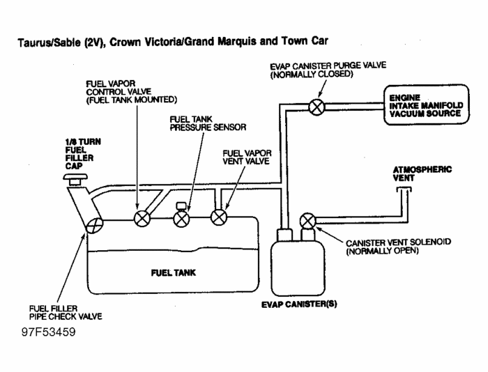

OK FELLERS
YOU KNOW BY NOW
IMMA JEEP GUY!
WITHOUT KNOWING SPECIFIC MODELS LIKE "LX", "SE", "SHO"
I PLUGGED IN "LX". STILL MAY NOT HAVE GOT THAT. THE ON-LINE MANUAL GETS CONFUSING!
I MUST HELP YOU CAR GUYS, IF CARS WEREN'T AROUND, JEEPS WOULD NOT "STAND OUT"!
THERE MAY BE MORE DIAGRAMS,
I JUST CAN'T FIND 'EM

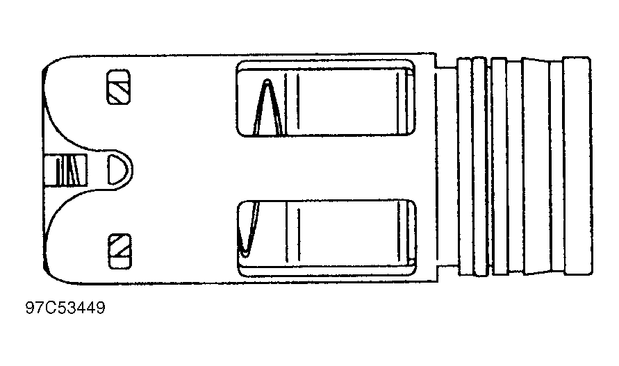

LOOKS LIKE "MAYBE" YA'LL MIGHT HAVE A CHECK VALVE IN THE LINE!
MAYBE IT'S STUCK/ OR PARTIALLY STUCK!
'ROUND HERE, "MR. SIPHONER" COULD HAVE DAMAGED IT! LOL. COM'ON THAT WAS A LITTLE FUNNY!
1ST DIAGRAM IS WHAT IT SHOULD LOOK LIKE.2ND (BOTTOM LEFT) IS WHERE IT MAY BE LOCATED.
AGAIN, FINDINGS. GOTTA KNOW THE END OF THE SOAP OPERA!
