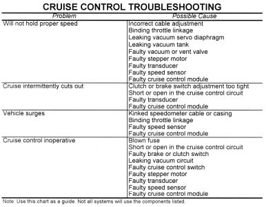

about 2 weeks ago my cruise quite working on my 97 taurus.took it in they checked all fuses and all were okay. i then replaced the cruise switches with new ones. but still no fix. so i replaced cruise modual but still no crusie.what or where should i go from here. please help

check these parts I am also putting a trubble shooting quide on here
https://images.2carpros.com/forum/automotive_pictures/52960_0900c1528003ac4a_1.jpg
Speed control amplifier/servo assembly Speed control cable Vehicle Speed Sensor (VSS) Speed control actuator switch Stop light switch Deactivator switch The speed control system operates independently of engine vacuum and, therefore, does not utilize any vacuum lines. The speed control amplifier integrates the system electronics, thereby eliminating any other electronic control modules in the vehicle. The amplifier controls the vehicle's speed via a cable attached to the throttle body lever. The speed control actuator switch assembly is mounted on the steering wheel and allows the driver to control the system's operation. The switch assembly contains five control buttons for system functioning, namely: ON, OFF, RESUME, SET ACCEL, COAST. The system will continue to control the vehicle's speed until the OFF button is used, or the brake pedal or clutch pedal (manual transmissions only) is
