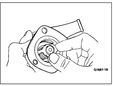

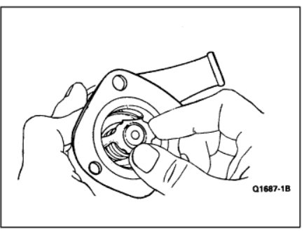

Hey I need help on locating my thermostat in a 91 ford ranger 2.3 L Iv looked every where but I must be missing seeing it and over looking it
If anyone has a clue as to where I might find this please let me know
( and if you could send me a diagram I would greatly appreciate it thanks )

The thermostat is located at the end of the upper radiator hose toward the engine. Here is a guide to help you see what you are in for when doing the job.
Here is a diagrams for what it looks like on your tuck (below)

I finally changed out the thermostat and it works like a charm thanks

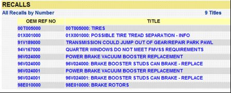

Also, it looks like you may have some recalls on your vehicle. The dealer may fix these for free. Please contact the dealer service department, give them the VIN number of your car and have them check on
these to see if they apply to you.
https://www.2carpros.com/forum/automotive_pictures/248015_Ranger_REcall_1.jpg
