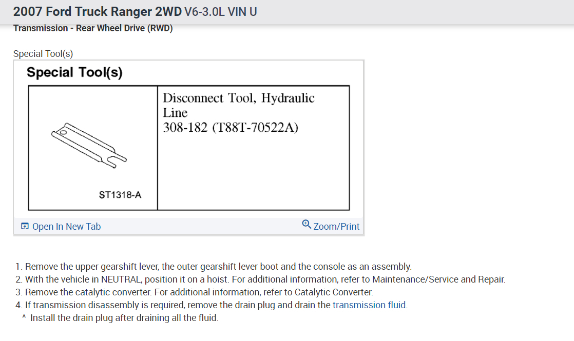

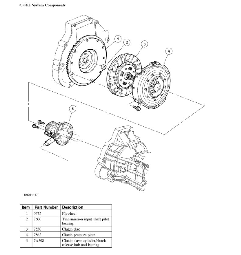

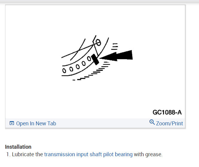

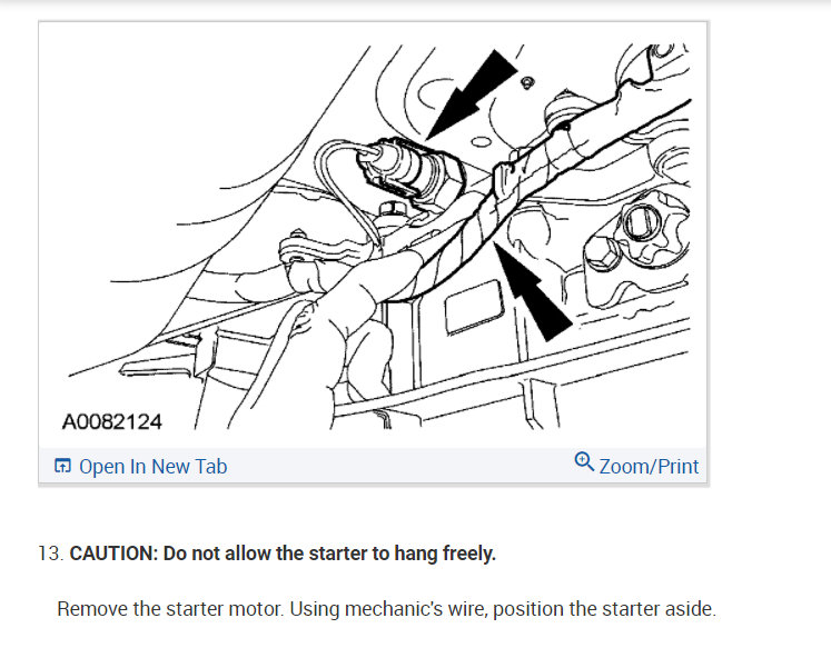

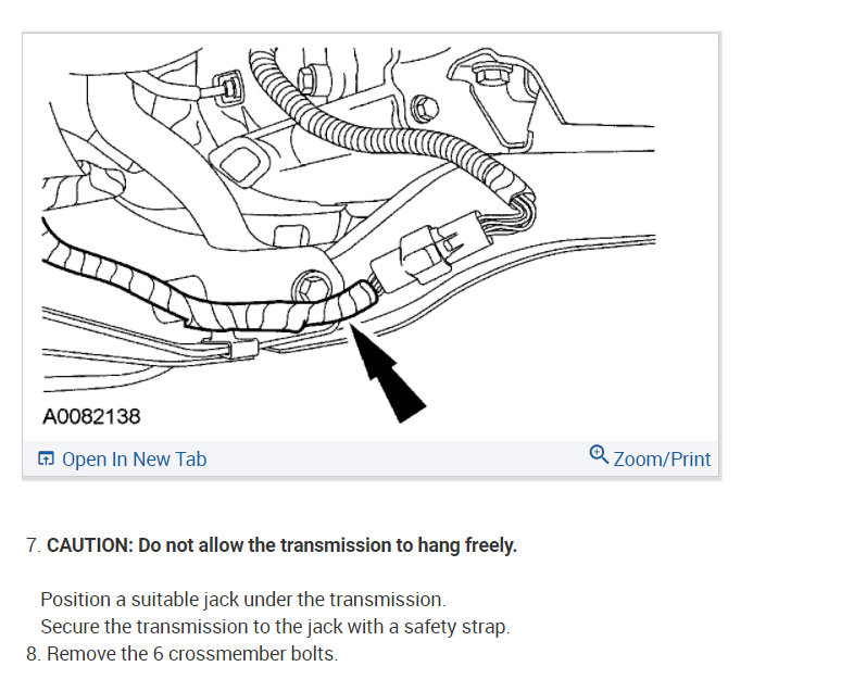

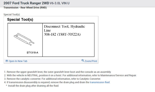

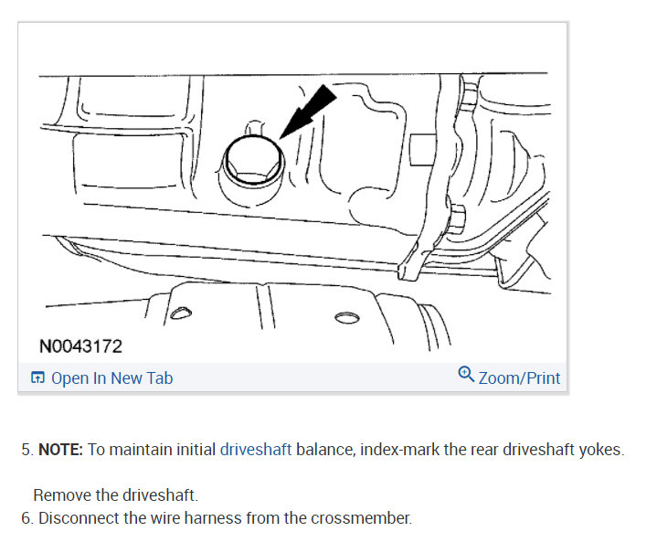

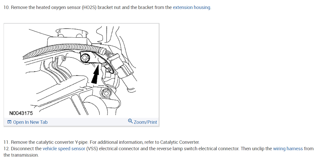

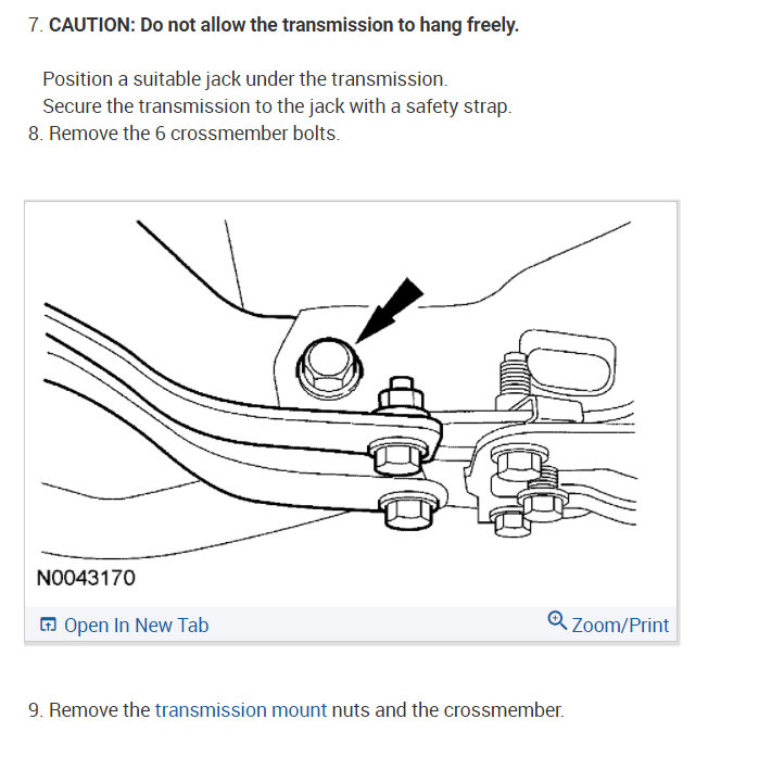

I am having a hard time putting it into gear. The clutch fluid was ok. It is rough putting it in any gear. I have to come to a complete stop, push the clutch in twice and it will go in rough but not grinding. I had this problem before about a month ago, but it acted normal until about a week ago. I need to replace the clutch.

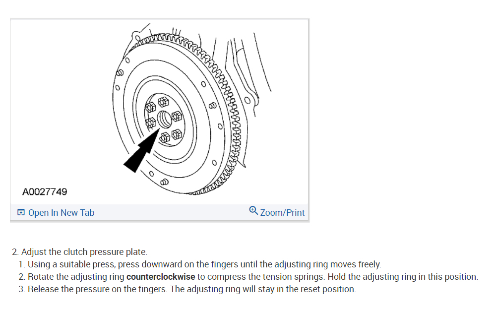

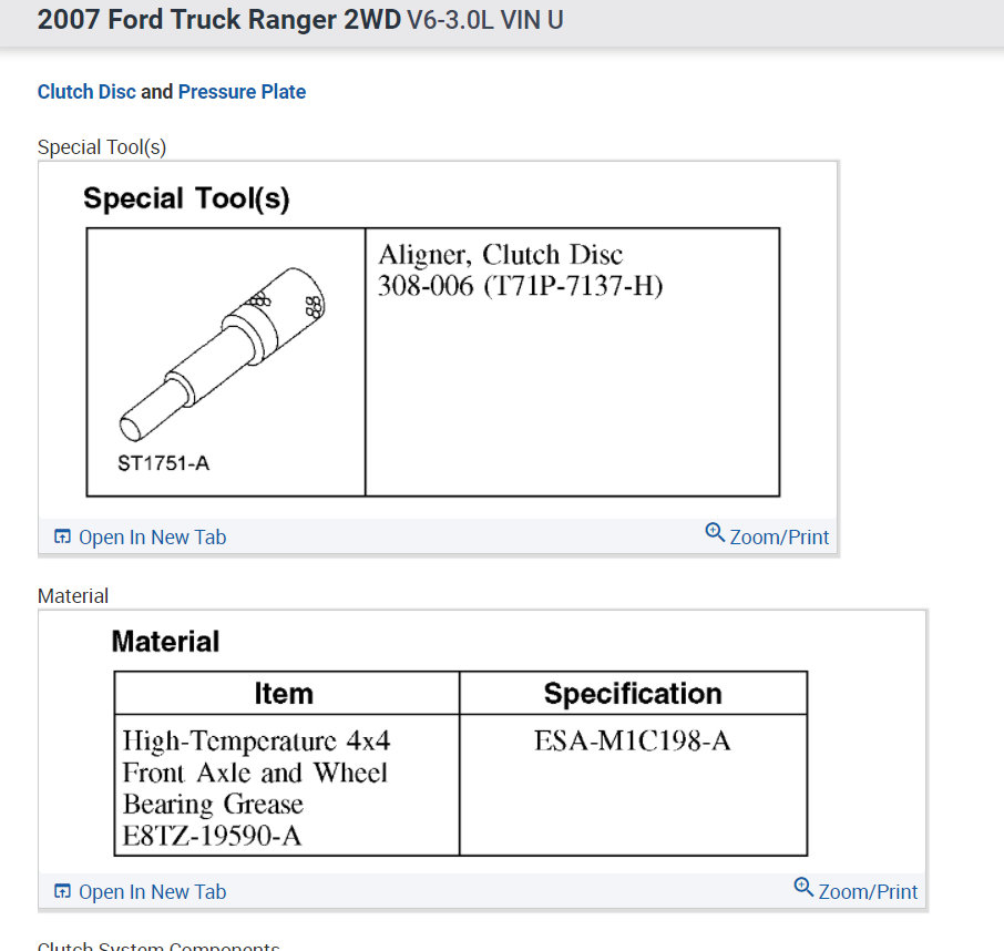

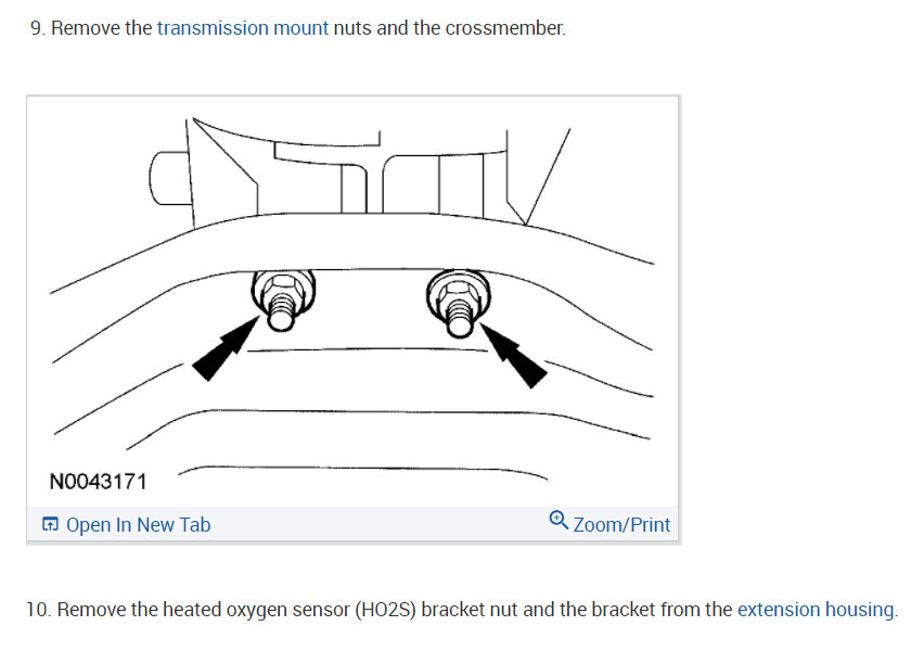

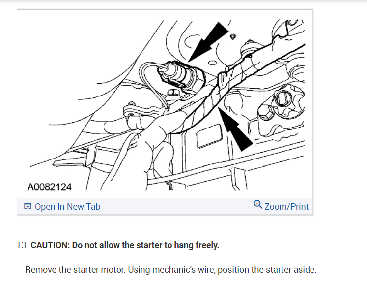

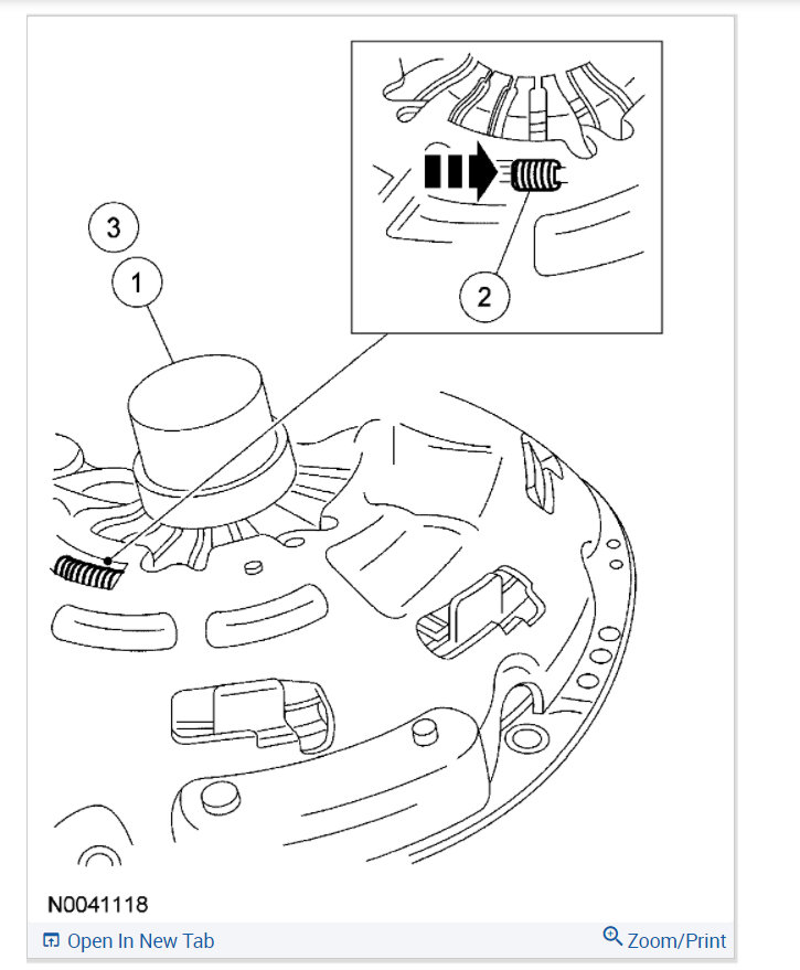

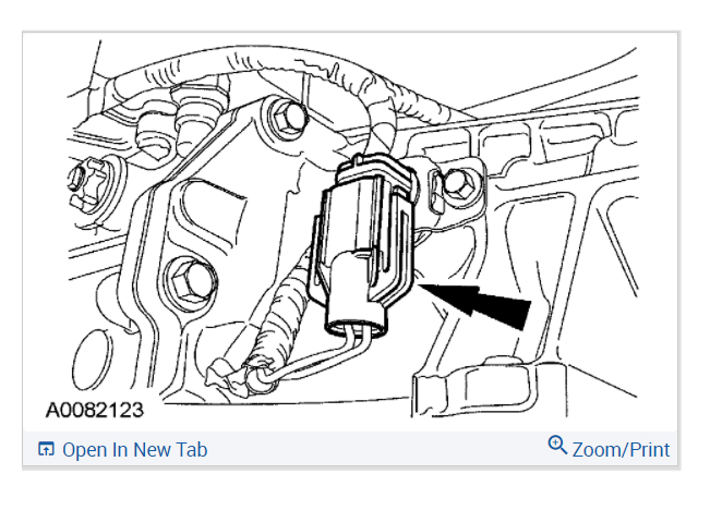

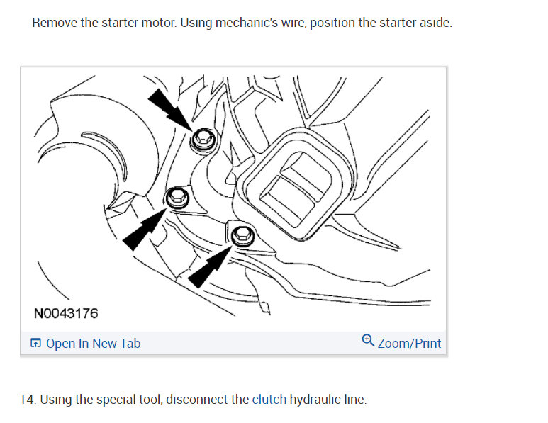

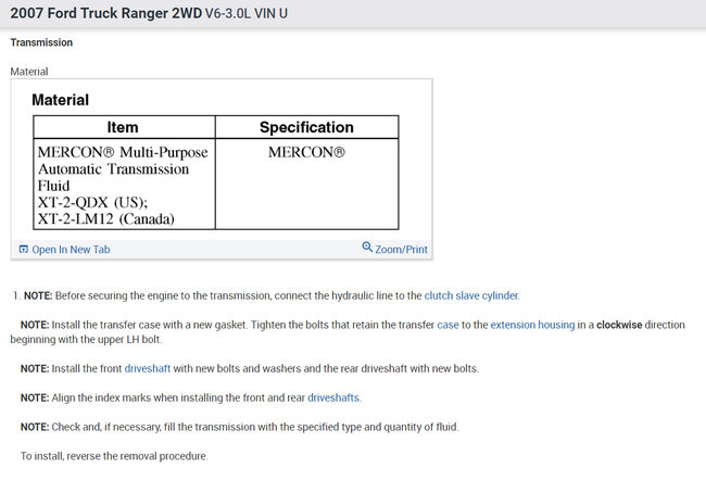

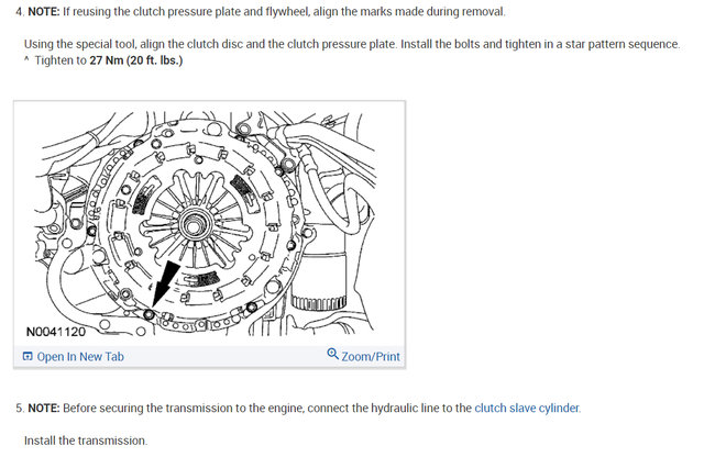

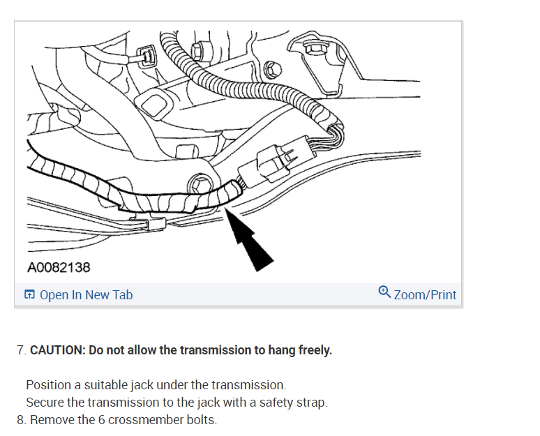

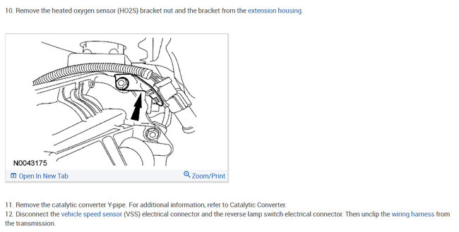

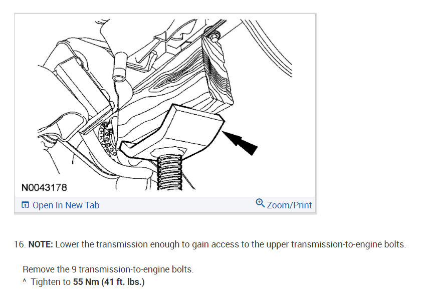

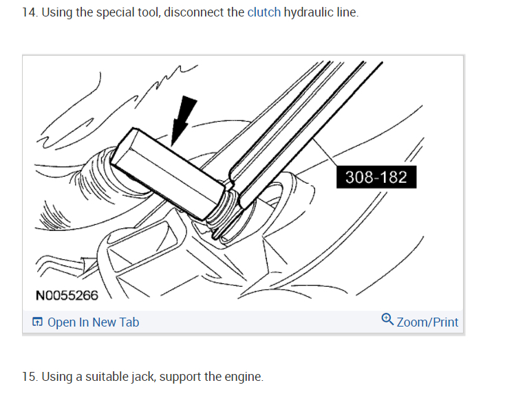

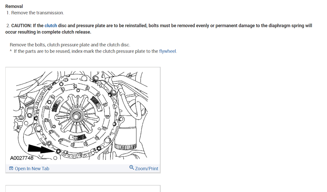

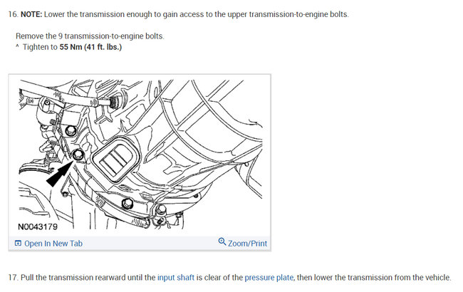

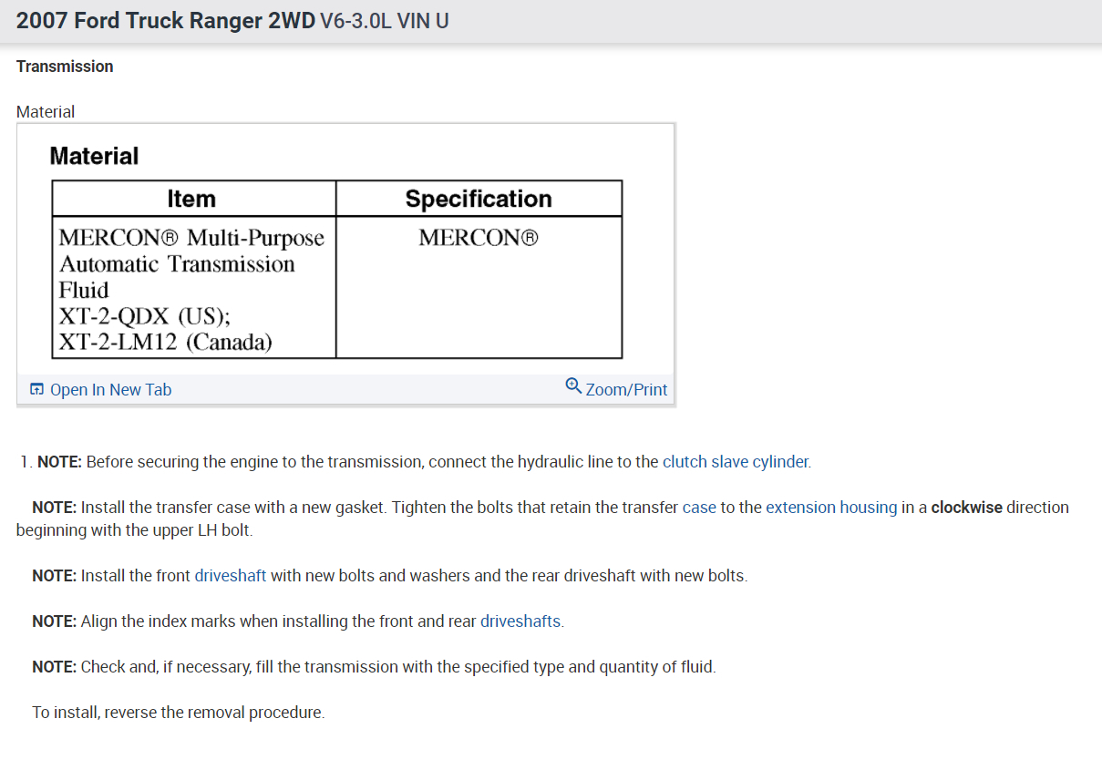

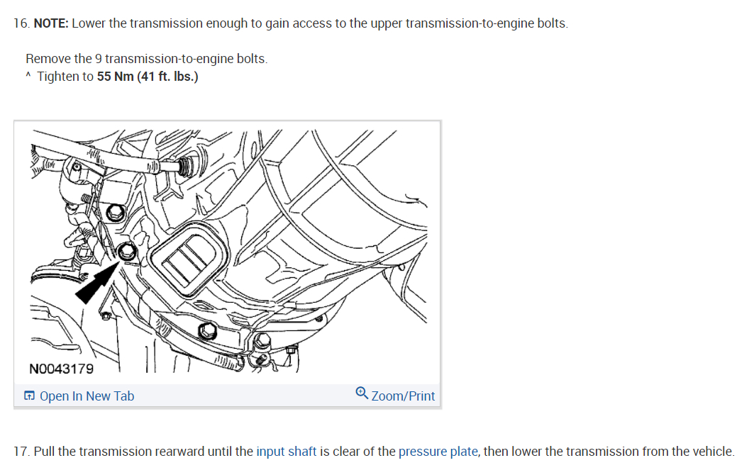

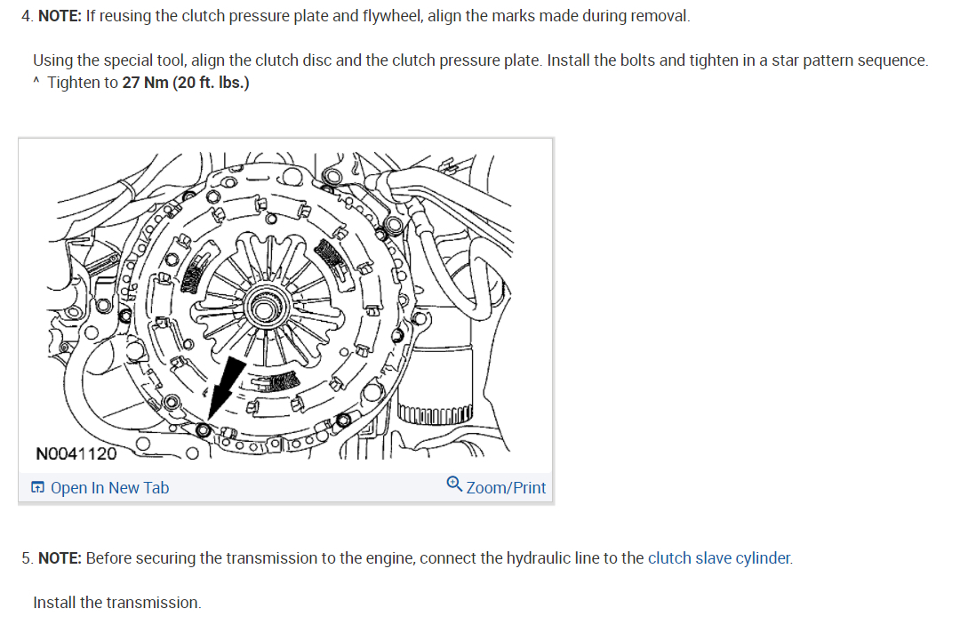

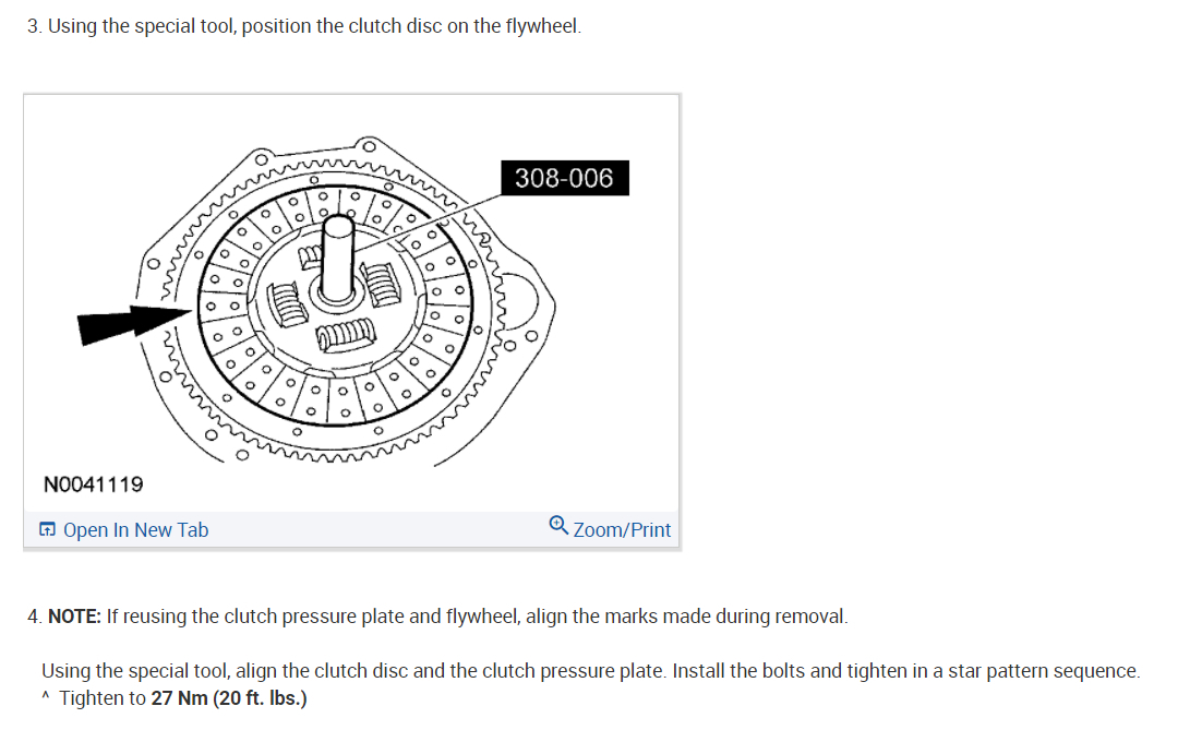

This video shows the job being done on a similar car but the process is the same with instructions in the diagrams below to show you how on your car:
https://youtu.be/JpzefqEeVGE RWD
Here is a guide to help you step by step with instructions in the diagrams below to show you how on your car:
https://www.2carpros.com/articles/how-to-replace-a-clutch
