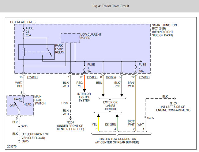

my ranger came from the factory with a 4 wire flat connector. i installed a 7 wire to pull a camper. it has worked fine up until now. i have lost marker/tail lights. i have checked all the fuses that i can find to check and checked all my wires. i don't have any broken wires. i cannot get current to the tail/marker lights. what else can i check ? thanks.

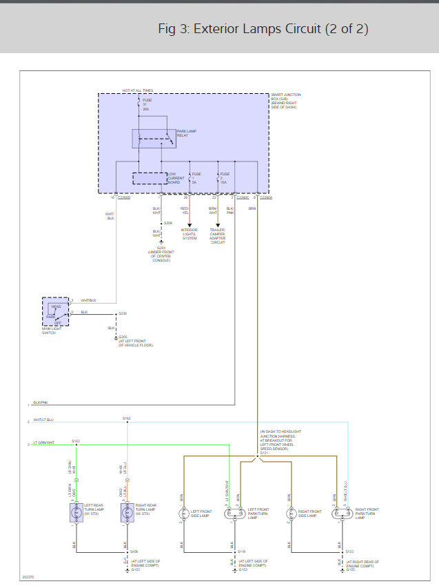

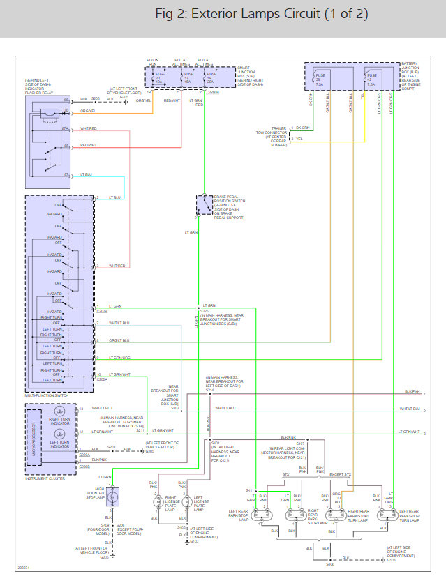

Here is a guide and the wiring diagrams you need to get the job done.
Cheers
