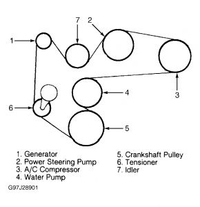

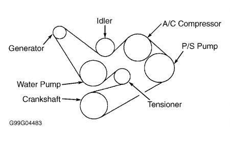

I have a 2002 Ford Ranger with a little over 130,000 miles on it. I just got it maybe a month ago and ever since i got it, when the motor goes above 2,500 rpm's it starts to make a noise and i cant tell what it is. Someone said it might be a belt slipping but which one would it be? Does anyone know?
Dec 3, 2008 at 3:30 AM
BMRFIXIT
  • 19,053 POSTS
you have only one belt check tensioner and idler pulleys
