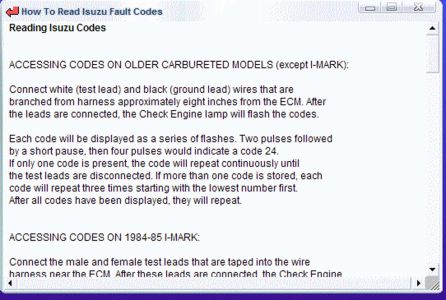

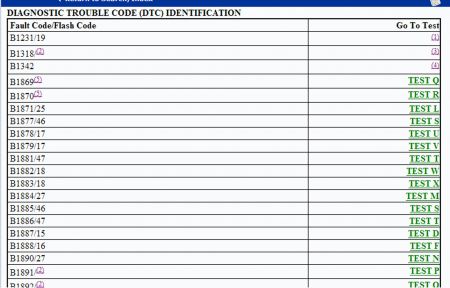

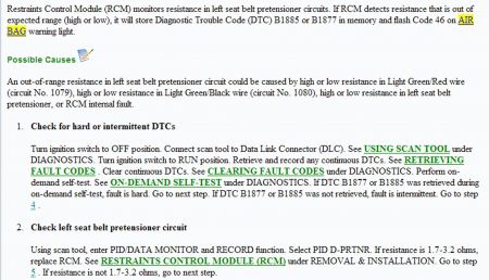

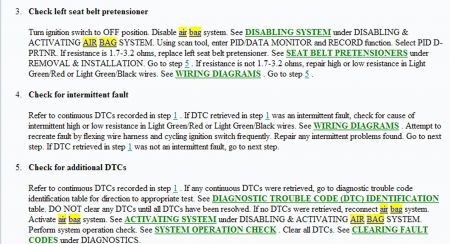

Ok you have a flash codes of 46 which is a B1877 or B1885 Left pretensioner, The only way further testing is possible is to have the right scantool, and do an on demand test, if you have the tool, Here are the tests..
https://images.2carpros.com/forum/automotive_pictures/62217_AirBags_1.jpg
https://images.2carpros.com/forum/automotive_pictures/62217_AirBags2_1.jpg
https://images.2carpros.com/forum/automotive_pictures/62217_Codes_1.jpg
https://images.2carpros.com/forum/automotive_pictures/62217_Pretensioner_1.jpg
