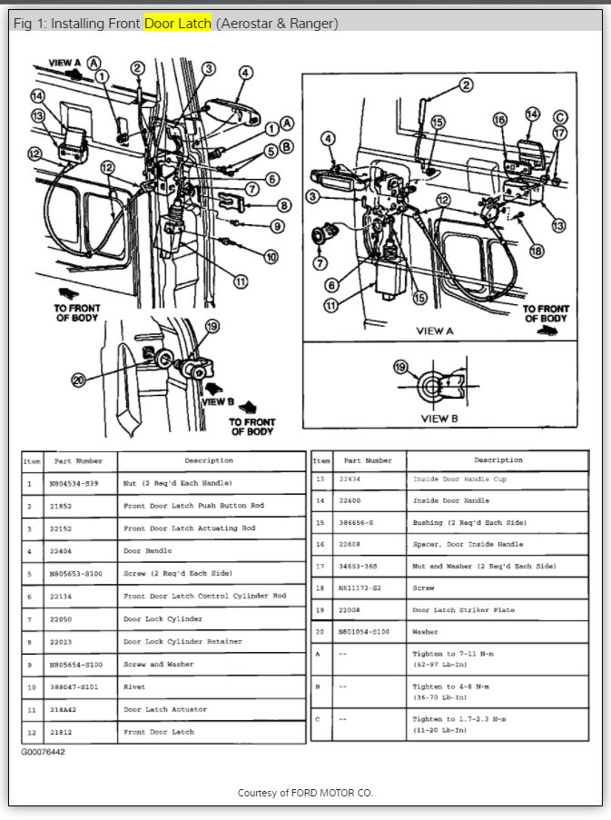

KEN L
  • MASTER CERTIFIED MECHANIC
  • 47,690 POSTS
What happens is the switch in the drivers door latch goes out then the system thinks the car is getting stolen.
Here is a guide to replace the latch and fix the problem. (below)
You will need to remove the door panel first.
https://www.2carpros.com/articles/door-panel-removal
