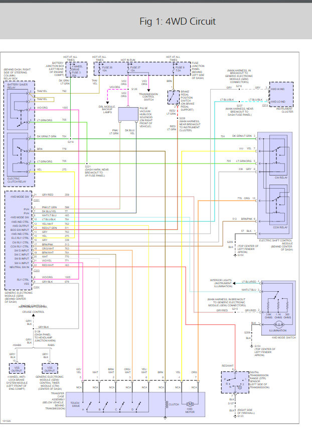

Electrical problem V6 Four Wheel Drive Automatic 134000 miles
Periodically, the 4wd hi and lo lights will flash 6 times then go off and will keep repeating until the truck is shut off and not restarted for a while. While the lights are flashing, the 4wd will not work. If they're not flashing it works fine. It seems as though it does it more frequently when it snows. I've already replaced a hub assembly thinking that was the problem, but it didn't.

This problem sucks, well i have 98 ranger with same problem but i think i may know what is wrong but as for us, we will just have to work this out I'm here to help.
I figured out that if you put it in 4x4 it engages all nice and everything but when i go to remove it from 4x4 it will sit their and click and if you let it sit and click about 3 to 4 maybe 5 times that is when the problem occurs and no 4x4 action at all and flashing lights but so far if you engage 4x4 with all noise down listen for clicking behind dash and just dont let it sit and click just try it and if it clicks more that 3 times put it back in 4 and try disengaging again till it dis engages before it clicks 3 to 4 times or so but i did try to replace it and it worked fine for day or too and then i had the same problem.

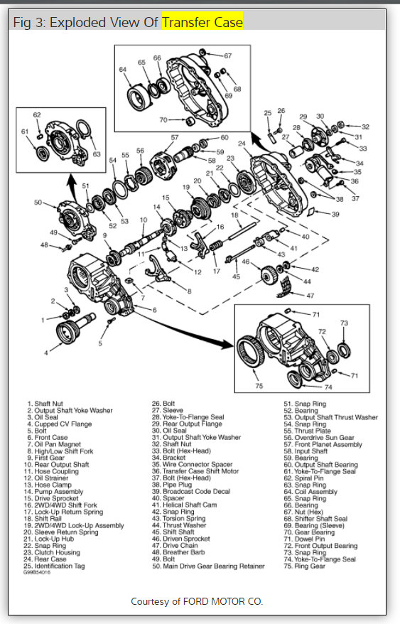

So I replaced the transfer case actuator and the problem is fixed. Here are the wiring diagrams and the encoder location #36 which I used to help me figure it out.
I hope this helps people, Cheers!

the motor on the transfer case may be failing.
did you check or change the oil in the transfer case??

  • 110,194 POSTS
If the light is flashing, you need to have the computer scanned when it does it. Chances are there is a short in the wiring at the transfer case actuator. However, the scan should direct you.
