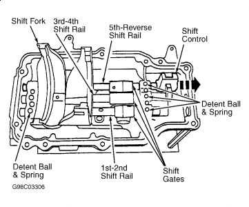

Changed the clutch and slave cylinder/throwout bearing on the truck. The shifter is stuck in neutral, and wont go to any other gear, even when the truck is running, and clutch pedal is pushed in.I bled the slave cylinder. Did I mess up on something?

Hi pull shift boot off unbolt shifter see if shifter is in place correctly with shift control. see diagram
https://www.2carpros.com/forum/automotive_pictures/198357_Graphic_391.jpg
Let me know
