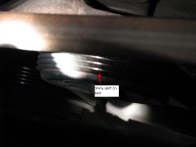

From what I could see I found one small spot where it looked like the belt might be a little wet. It was the only spot that reflected the light from a flashlight.
https://images.2carpros.com/forum/automotive_pictures/537992_IMG_5010b_2.jpg
Would such a small spot cause the slipping or is it an indicator of a leak and there are more spots I can't see or that have evaporated overnight?

It looks like I'm looking at the water pump pulley. Is that correct? If so, check under the pump. There is a small weep hole that is there in the event that the bearing or seal go bad in the pump. If they do, coolant will leak out of it and yes, it could cause the belt to slip.
Let me know what you find.
