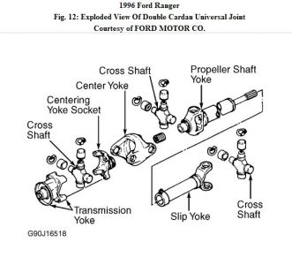

OK, I would take another good look at the U-joints. Check them with the truck in neutral so there's no tension on them.
If U-joints check out OK, we go back to tires. Do you feel the vibration more in the seat or in the steering wheel? If one more so than the other, switch your tires front to rear and see if the shaking follows. Let me know.

A wheel bearing , as a rule, won't shake unless they are "COMPLETELY" shot. They may make a whole lot of noise, but not shake. In checking the U-joints, be sure the trans is in nuetral so you have no torque on the driveshaft. When checking them, your looking for any twisting or up/down movement of any joint. If a joint is so bad that it shakes the truck, it shouldn't be hard to spot.
https://images.2carpros.com/forum/automotive_pictures/248092_ranger_ujoint_1.jpg
