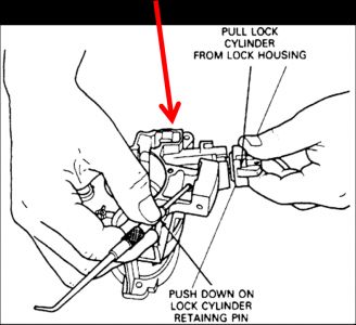

As you see by the steps in the attached you have to turn the key to run engage lock into position.a re you sure you rotated the cylinder and locked it into position?
Please make sure it is seated and do the functional check.
Note: The following procedure applies to vehicles that have functional lock cylinders, ignition keys available for the vehicle, or ignition key numbers that are known and the proper key can be made.
REMOVAL
Disconnect battery ground cable, then remove steering wheel.
Note: Ensure steering wheel is in full up position on models with tilt steering.
Turn lock cylinder key to run position.
On models with tilt steering, remove tilt lever, then the steering column collar by pressing on collar from top and bottom while removing.
On all models, remove lower dash panel trim cover, then the column shroud retaining screws from bottom of column shroud.
Remove bottom half of shroud by pulling shroud down and toward rear of vehicle. Move shift lever as required to ease shroud removal on models with automatic transmission.
Lift top half of shroud from column.
https://www.2carpros.com/forum/automotive_pictures/248015_1_131.jpg
Push down on lock cylinder retaining pin using a 1/8 inch diameter wire pin or small punch, then pull lock cylinder from column housing, Fig. 2.

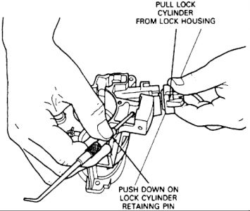

Place a 3.17mm (1/8-inch) diameter wire pin or small drift punch in hole in steering column under lock cylinder. Depress retaining pin while pulling out on lock cylinder to remove it from housing of steering column.
https://www.2carpros.com/forum/automotive_pictures/248015_2_84.jpg
Installation
Install lock cylinder by turning it to RUN position and depressing retaining pin. Insert lock cylinder into steering column housing. Make sure ignition switch lock cylinder is fully seated and aligned in interlocking washer before turning key to OFF position. This will permit retaining pin of ignition lock cylinder to extend into hole of steering column.
Rotate lock cylinder, using key, to make sure of correct mechanical operation in all positions.

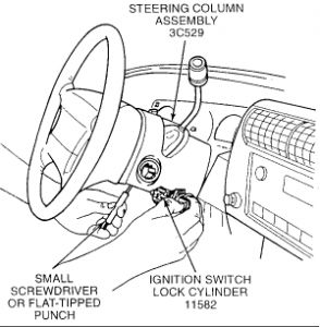

You did say you reached up under and pushed the rod to shut off.okay, are the rods in the correct spot? is it worn or broken where it connects? Have you performed a very good visual of each and ever little area? is something broken? slipped out? cracked and allowing it to flex once on. I put another picture with the arrow for anything broken etc.
https://www.2carpros.com/forum/automotive_pictures/248015_Picture4_18.jpg
Remove the key lock. I am not sure how yours is made, but are you able to use pliers or screw driver to turn to start? My reason is if you can without the key lock then see if once turned on if it is loose internally that will eliminate the key cylinder.
To me it is right there in the column area the rods key cylinder etc.
What do you think?
