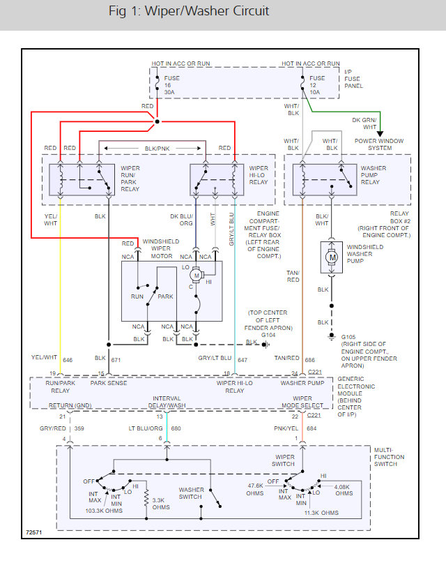

I got such good help on here the last time, I will throw this out there. I flip the control switch for the windshield wipers, but nothing happens. I have checked fuses/relay switches, they seem fine. How can I tell if it is the motor for it or the actual control on the steering wheel that is bad? Or any other ideas on how to test to see what might be wrong?

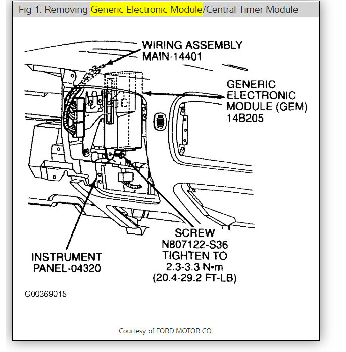

This system sues a GEM which go out here is the wiper wiring diagrams so you can see how the system works with the GEM location as well.

Check for power getting to the wiper motor. If there is power there when the switch is on, the wiper motor failed prematurely. If no power is getting to it, check back at the switch.

Check the ground
make sure wiper motor have a good ground

Didn’t you replace the wiper motor?/
make sure the motor have a good ground on it
use a test light hook the elicitor clips to a battery power source then touch with the other side of the test light the wiper motor tester should light up
if not run a ground wire
hope that what you are looking for

I went back and read your original post and it say you hear a click when you turn the wipers on
so the switch is giving the order
plus I don't know what are you looking for !

Common sense would say no. If you hear clicking when you turn the switch on then the switch is ok and its something else not working. Check again the ground on the wiper motor. Try different positions on the switch when turning it on if the motor works then its probably the switch. You have to do some checking unless you want to just throw parts at the car.
