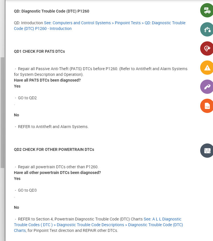

We were driving the car and it suddenly stopped. The mechanic says it's code P1260 Theft Detected - Engine Disabled but isn't sure how to remove that code and get it to run again. How do you remove that?
Jan 8, 2009 at 12:44 AM

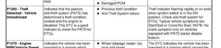

This code is unlikely to cause the engine to stop running once it is started and driving. It can cause a start and stall, but it should not cut the engine off while you are driving down the road.
So, I suspect the engine stalled and then it entered into a theft mode.
So, the way to get this code to clear is we need to disable the theft mode.
https://www.2carpros.com/articles/how-to-reset-a-security-system
Also, we need to make sure there are no other codes. Normally this code is just an informational code that will tell you that there are others.

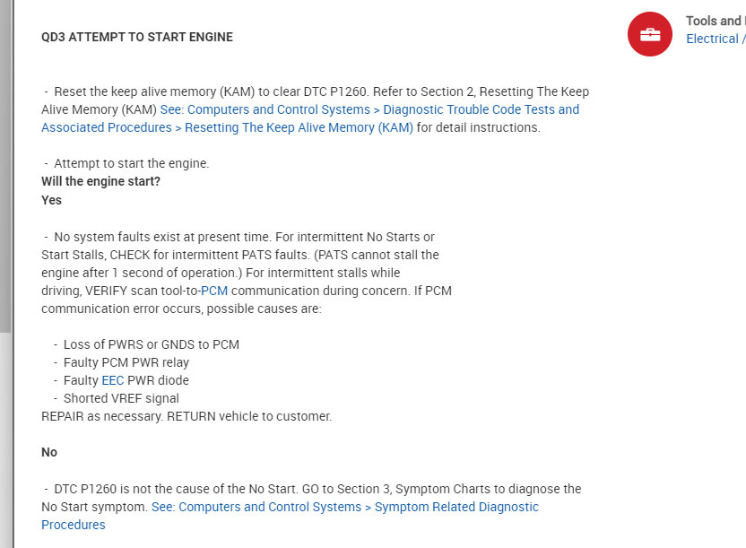

If not, we need to find out if there were any engine related codes that could explain the cut off.
If there are no other codes and this is the only one, then we need to simply reset the memory by disconnecting the battery and then retest the operation.
Please run through this info attached and let us know what you find.
