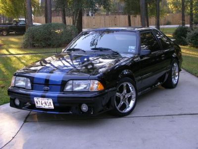

I have a 1988 mustang gt. The car has about 190,000 miles. The motor has been rebuilt and only has 15,000. We rebuilt it to a stroked 347, with a mild cam. The problem i am having is that when i turn on my a/c my water temp goes way up, sending the temp gauge one notch below the red. What do i need to do to fix this problem?
