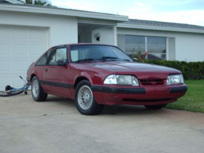

My 1990 Ford Mustang LX has a bad knock coming from under the hood. I've talked to many people and mechanics and they've all mostly not known what it is. I know I have a bad clutch, and the knock sometimes stops for short periods of time when driving. Could it be the throw out bearing? Just wanted to see what u guys thought before I spend to much money. And if u could send me a link or email to a part's list for converting a 2.3 liter N/A to the 2.3 liter turbo, like the SVO Mustang or the Merkur XR4TI enigne. thank's alot
