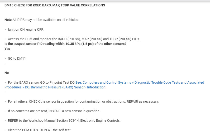

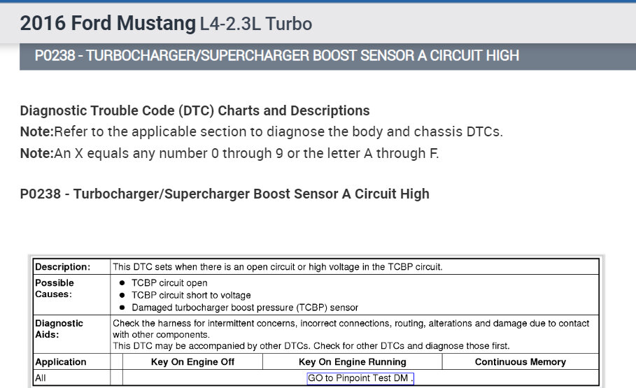

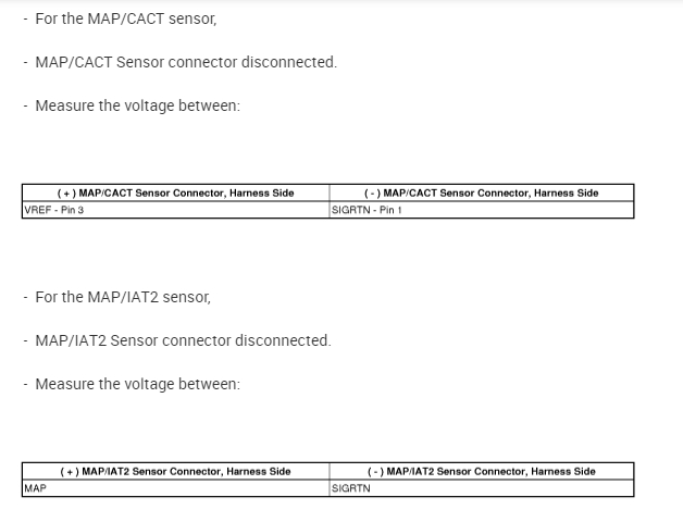

Hi, I have been trying to figure out what is wrong with my car, I have changed the MAP sensor and I still get this error.
Feb 9, 2023 at 6:13 AM
  • 110,240 POSTS

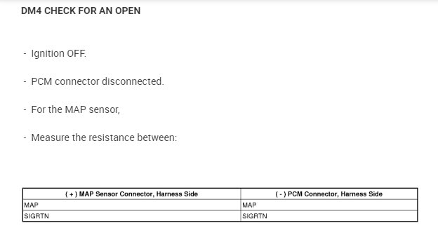

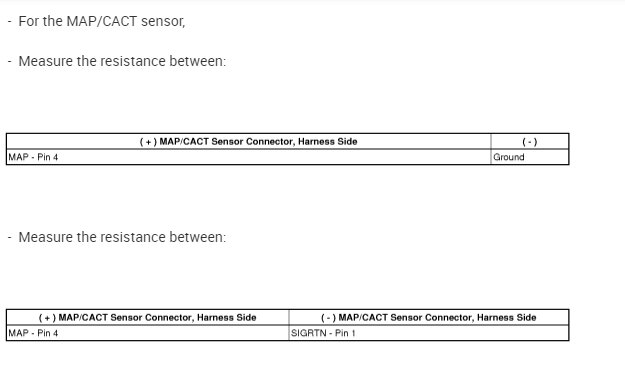

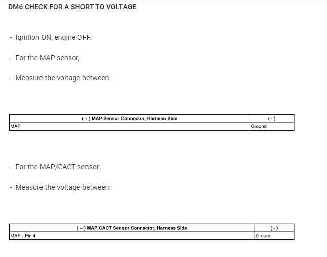

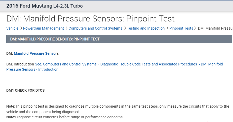

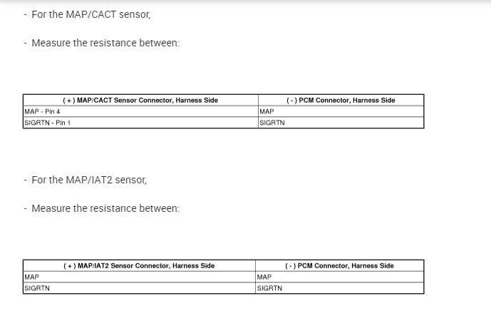

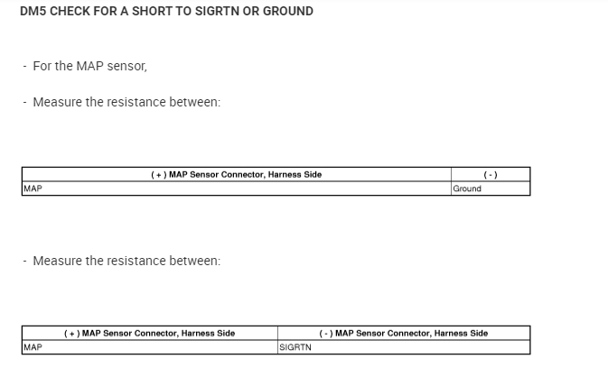

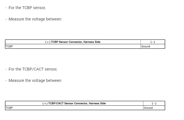

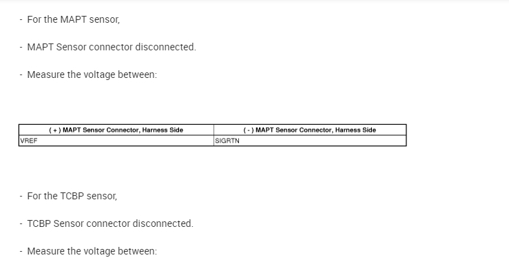

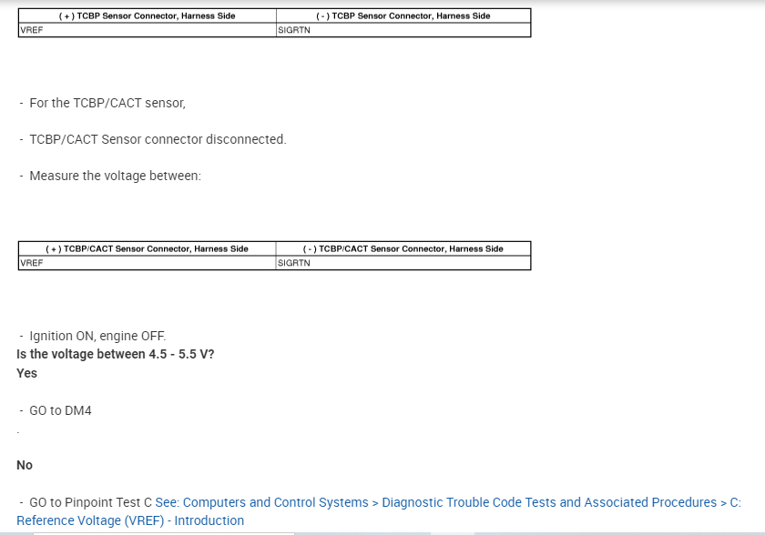

The code is related to the turbocharger boost pressure sensor. Either the sensor is faulty or there is a wiring issue. See pic 1 below.

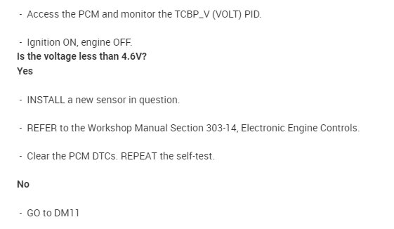

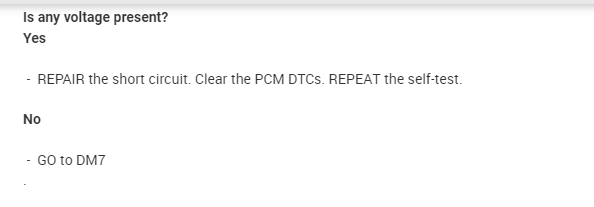

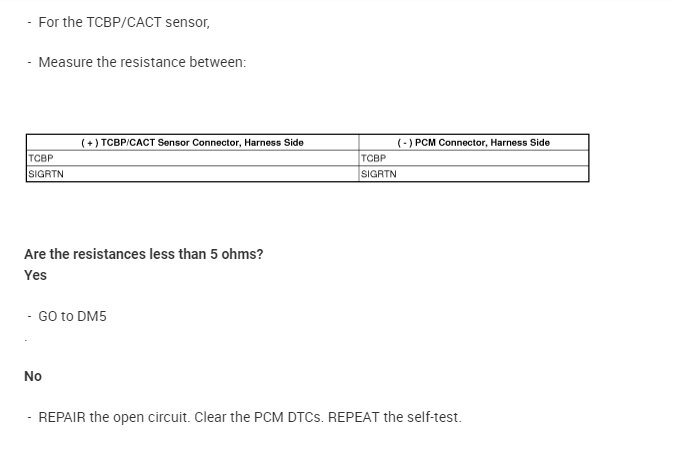

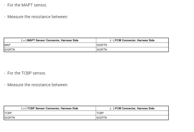

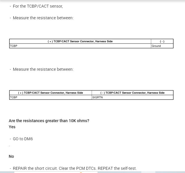

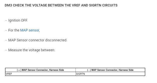

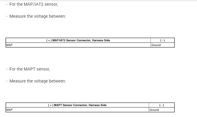

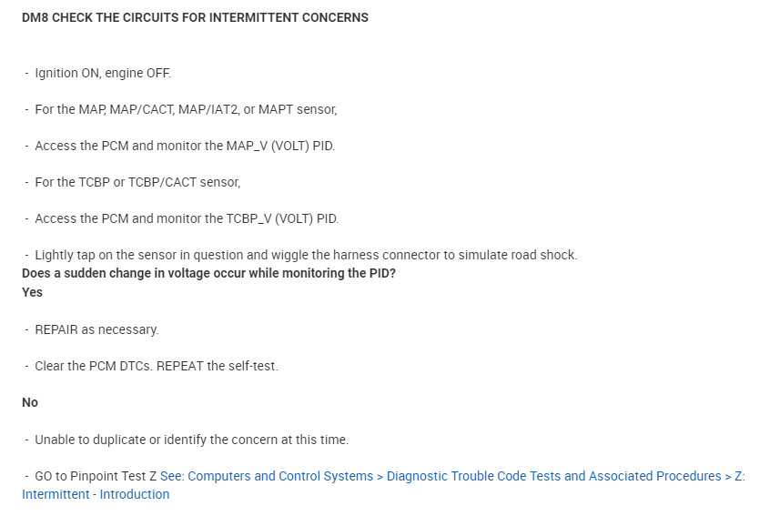

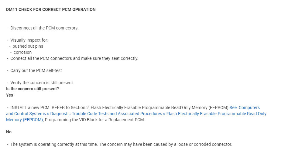

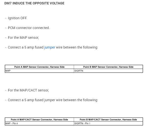

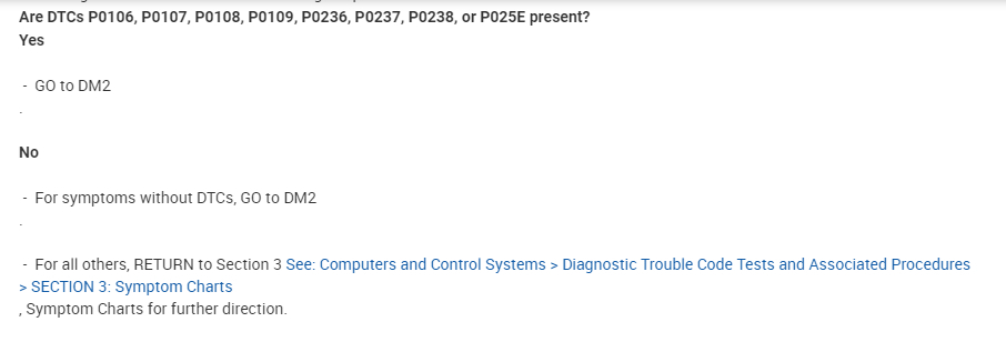

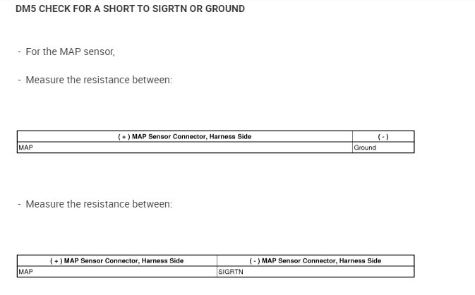

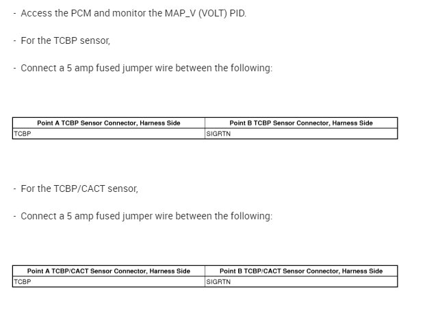

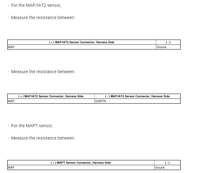

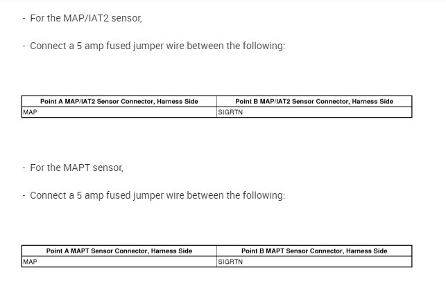

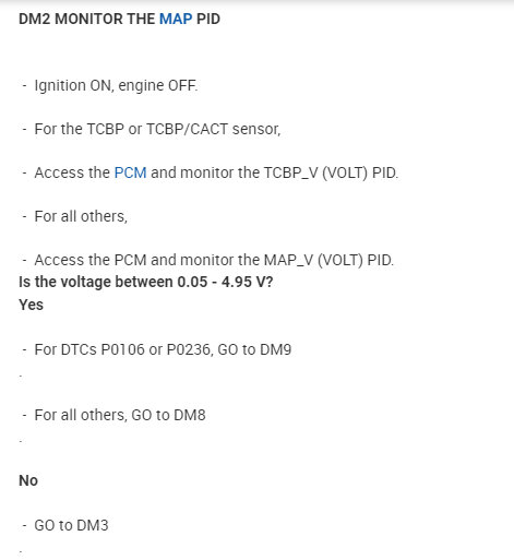

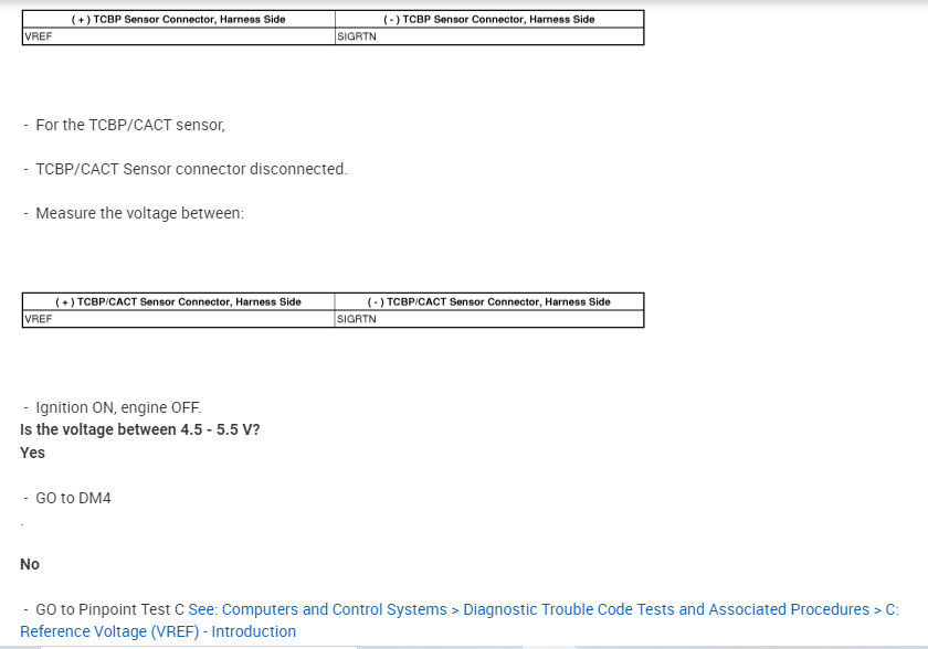

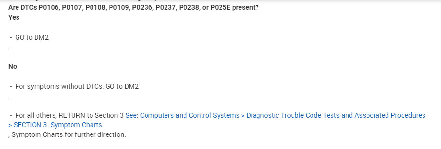

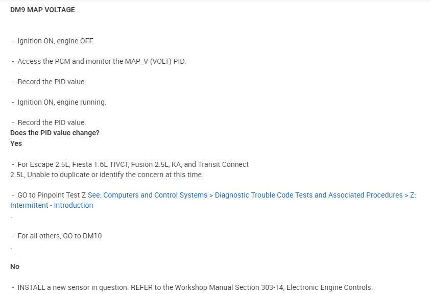

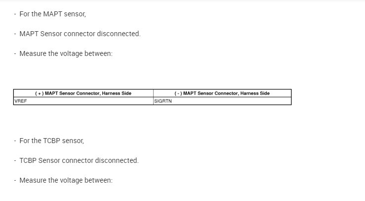

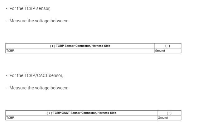

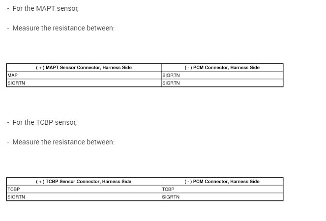

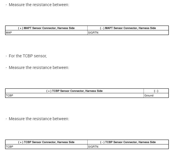

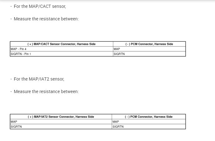

I attached the diagnostics specific to this code starting with pic 2. Don't be overwhelmed by how many steps are listed. Based on the results of each test determines where you move next or how to repair the problem.
Take a look through them and let me know if you are comfortable performing them.

How would I determine whether the wires are corroded or damaged? As well as the PCM?
Feb 13, 2023 at 4:39 AM
  • 110,240 POSTS
As far as corrosion, the only thing you can do is disconnect the connector to see if they are damaged or corroded. Ken is correct when indicating that corrosion can adversely affect the sensor signal. Anything that creates resistance will change the end result. As far as testing wiring, you can use a multimeter to check continuity.
As far as the PCM, often times a diagnostic trouble code will be prompted indicating an issue. With the code, you diagnose the possible cause by testing.
Let us know what we can do to help.
