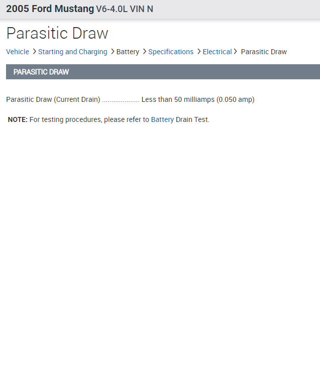

Car only gets driven once or twice a week. I believe the anti theft warning light drains battery. Is there a way to make light stop flashing, or if it could be something else?

The anti theft warning light does have the capacity to drain the battery, but it should take longer than a week.
Please note that every vehicle has certain amount of parasitic drain in the electrical system. Which will make the battery loose charge overtime and go completely dead after a certain period of time. That time will depend on the components of the electrical system of that particular car.
However many times you can have excessive parasitic draw/drain in your electrical system due to a faulty component. Like a glove box light staying on or a shorted window switch etc.
You can check and measure the parasitic draw by using a multimeter.
The Parasitic Draw (Current Drain) specification for your vehicle : Less than 50 milliamps (0.050 amp)
