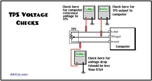

Ok, appears the IAC is good. I will ask the other techs to post test proceedure for the other components and the thoughts on your problem. I don't have access to my to get the proceedures. I am out of state for a few day. In mean time if you can test the TPS (Throttle Position Sensor).
https://www.2carpros.com/images/question_images/199385/original.jpg
You can measure the sensor's output voltage by packprobing the sensor conenctor with a voltmeter. First, check for the presence of voltage at the TPS with the key on. The TPS cannot deliver the proper signal if it does not receive reference voltage from the computer. Refer to a wiring diagram for the reference connection and look for 5 volts. The second check is the base voltage reading. Compare the voltage reading to the manual specifications. TPS voltage values are often specified to the nearest hundredth of a volt, so if the base TPS voltage reading is not within .05 volts of the specified value, adjustment may be needed (if it is adjustable). If it is not adjustable and the reading is out of specifications, replace the sensor. The third check is for the proper voltage change as the throttle opens and closes. Voltage should rise smoothly from about 1 volt to a maximum of 5 volts at wide open throttle. No voltage rise or skips in the reading means the sensor needs to be replaced.

In the first pin for computer reference voltage to TPS, I got a constant reading of 5.10v
In the second pin for TPS output to the computer, I got a constant reading of 0.04
For the third pin for voltage drop I got a constant reading of 0.6v.
All these readings were taken with the key in and turned to ON.

Did you actuate the Thottle while test each pin? If not do so and post results. Engine Coolant Temperature Sensor Test Engine Coolant Temperature (ECT) sensor uses a 5-volt reference voltage during engine operation. To check ECT signal voltage, backprobe between signal terminal and ground with engine running. To check sensor resistance, disconnect sensor connector and measure resistance between sensor terminals. For ECT sensor specifications, see ENGINE COOLANT & INTAKE AIR TEMPERATURE SENSOR SPECIFICATIONS table. For additional testing information, see TEST DA under SYSTEM TESTS in SELF-DIAGNOSTICS - EEC-V - CNG & GASOLINE article.

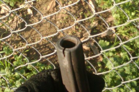

No problem at all, I really appreciate all of your help. I was looking around under my hood and I have coil on plugs and I took out the 3rd coil and noticed that the boot was ripped at the end. I looked around on forums and noticed that other people had misfires, noticed their boot was ripped and replaced the coil. I did run continuity tests on that coil and the primary and secondary resistance match up. Here's a picture of the ripped boot.
https://images.2carpros.com/forum/automotive_pictures/470862_IMAG0049_1.jpg
