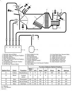

Car was running good, until hit a small pot hole in the road. My a/c was blowing cold as well. Now when I start my car the a/c is blowing hot air and the car is idleing up and down and you can hear it sucking air like a hose came off or something. When the a/c is off it idle just fine. Please help!

Ok I would check to see if the vacuum hose came off somewhere or if the vacuum reservoir some how got damaged see pic below 12 is where the vacuum comes from and 14 is the reservoir that I am refering to. Let me know how it goes.

Well guys I went and got a diagnostic test done and come to find out it was my CCRM that was makeing my car do that. So thank you guys for all the help.
