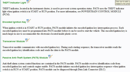

BTW what is the security light on the dash doing when trying to crank? It should be off!

If you changed the ignition switch is it possible you damaged the transponder wires?
https://www.2carpros.com/forum/automotive_pictures/62217_98PATS_2.jpg

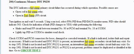

Another PM answer:
https://www.2carpros.com/forum/automotive_pictures/62217_Fuel_2.jpg
Test wires between PCM and CCRM, check the connectors...
