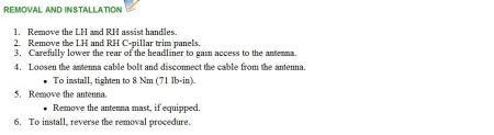

I am an ex-pat living in Cyprus, 80 miles from my nearest Ford Agent....My local car wash snapped off my antenna whilst trying to unscrew it. Is this a repair that an enthusiastic DIY can tackle or are specialist tools required. I can purchase one on-line and have it sent to me.

https://images.2carpros.com/forum/automotive_pictures/261618_Noname_2906.jpg
https://images.2carpros.com/forum/automotive_pictures/261618_Graphic_766.jpg
