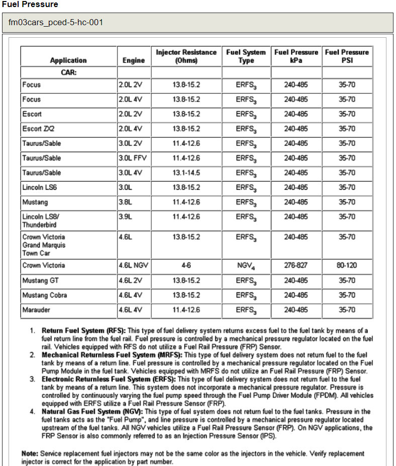

fuel pressure specs for zetec 16 valve 2 liter engine?
May 26, 2010 at 10:46 AM
DOCFIXIT
  • 18,828 POSTS
From 35 - 65 psi here is a guide to help you see how to check the fuel pump pressure.
If your vehicle doesn't have a schrader valve on the fuel rail, you will need a fuel injection test kit to tap into the line either after the filter or where the line attaches to the fuel rail
Cheers

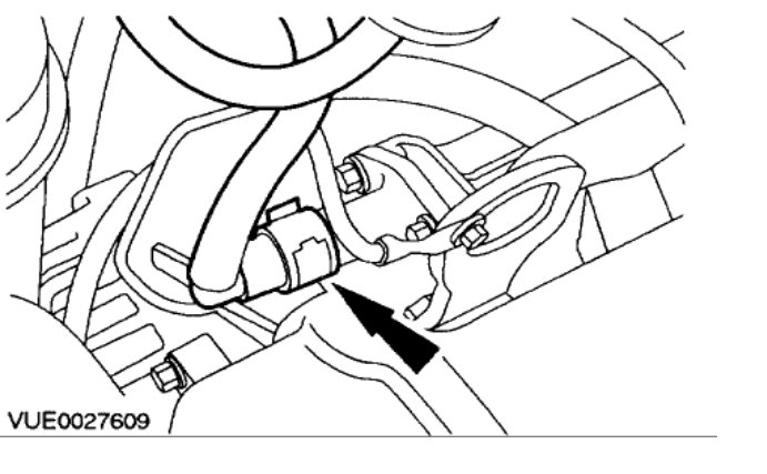

  • 54,837 POSTS
You need to tap in by the engine where it connects from the frame to the fuel rail. Here shows the gauge set you can rent for free at the auto parts store which will come with the adapter to tap in

  • 48,601 POSTS
we have no amp draw specs pressure should be 35-55 psi with key on only. auto parts rent it see link. if it blows the fuse it is too much draw or wire shorted out.

  • 48,601 POSTS
pressure shold be 35-55psi, check for a bad regulator or maybe the fuel filter was installed backwards

  • 19,053 POSTS
fuel pressure for 2.0L engine 35-65 PSI
